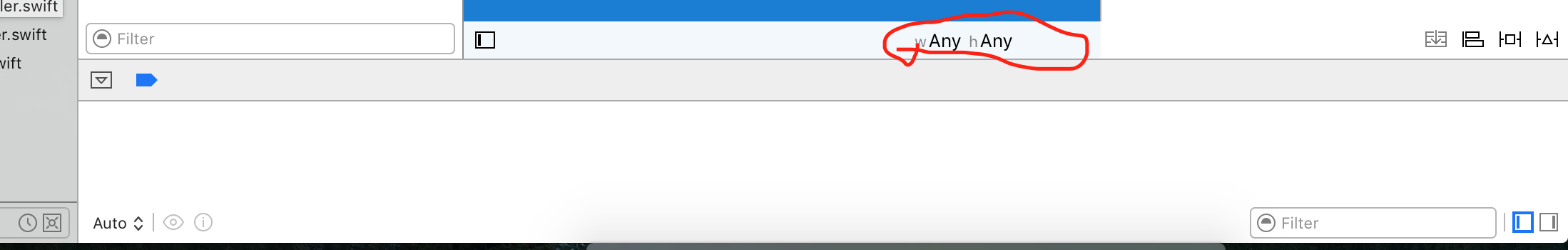

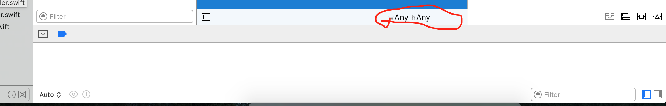

In interface builder (the storyboard editor), look at the bottom bar just above the debugger. In the middle of it, it should have two values. Tell me the two values that show up.
Maybe you have an old interface builder document. Try making a new one and creating a random view controller and connecting that one to your view controller code. See if it will load by placing colored views. Then report back. If that fixes it, its an interface builder issue. If not, its a code issue.
