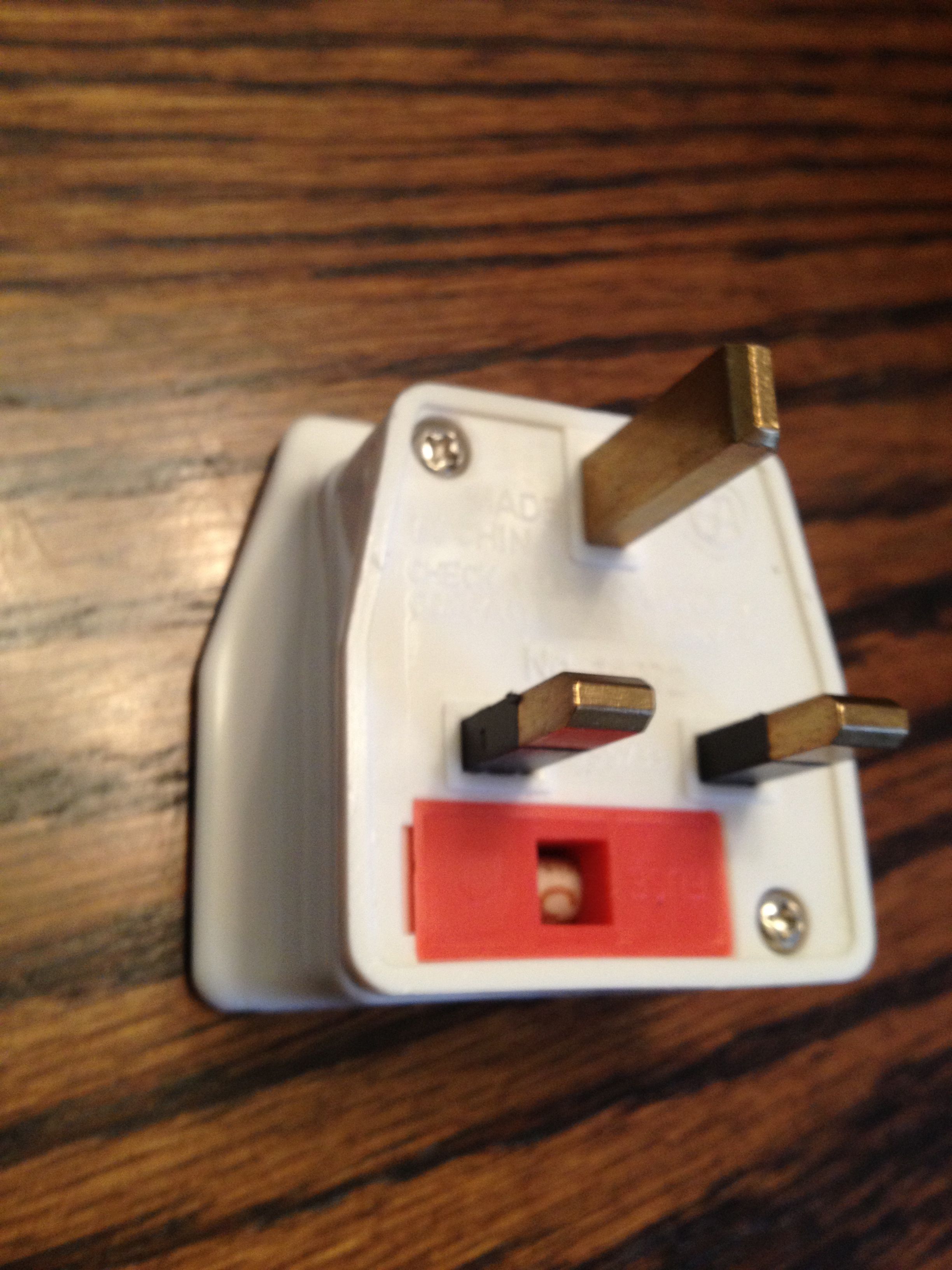

Circa 6 weeks ago I bought my first MacBook Pro (13''). I went to UK and I bought EU to UK adapter but I don't know which fuse I should pick?

But the connector that you plug into socket have place for fuse and you can put 3A, 5A and 13A fuse and I don't know which one is correct

Isn't the fuse boy the place to put the fuses into? Anyway, a 3 Ampere (3A, though I never heard of such a weak fuse) fuse will suffice, even at 100 V, as that is 300 W power (P = U times I; P - Watt, U - Volt, I - Ampere).

All UK plugs have fuses in addition to the Breaker in the Consumer Unit.
The correct fuse to use would be either 3A or 5A. Most plugs come with 13a fuse but would not recommend that.
