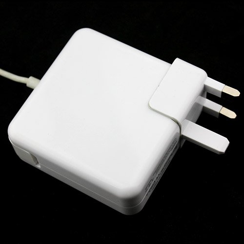

One thing that's annoying about the UK chargers is that the plug bit it quite fat and makes it hard to pack the charger in a smallish bag.
Noticed this charger on Amazon and was interested in the much slimmer plug part.
http://www.amazon.co.uk/Replacement-Magsafe-Adapter-Charger-13-3-inch/dp/B009YRUWO4
Anyone know of anywhere that may do just the plug bit in this slimmer style? Don't really want a 3rd party charger. Guess I could buy this and just use the plug part, but thought I'd throw it out there to see if anyone has seen them.

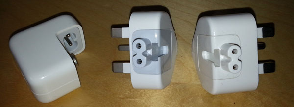

Some of my Apple mains plugs are noticably slimmer than others (see centre of pic - the one with the grey insert) and fit flush with the adapters, although the 'wings' stick out just as far. I'm pretty sure that the slim ones came with old-style Apple iPad/iPod adapters - but they are completely interchangeable with Mac ones (and I've just checked that they have the same 3A fuse).
Not sure if this helps you, unless you can find a 2nd hand iPad adapter with the right plug (they're jolly useful as universal purpose USB chargers anyway).

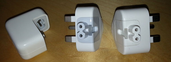

Cheers, however it's the width that's annoying and makes it bulky. On the one I posted, the plug piece is just a little wider than the charger itself, making it more "compact".

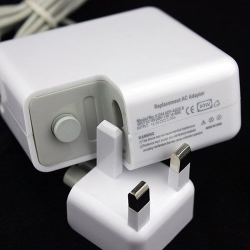

The smaller attachment you've linked to on Amazon is an unoffical adapter, and is likely unsafe, especially given the plastic third prong (it's not grounded).

As others mentioned, that third prong isn't just earth (ground) like in the USA. UK sockets have "Shutters" over the hot & neutral holes, and that 3rd prong is longer than the others - even when earthing is not required, the pin is still present in order to engage a mechanism in the socket to open the shutters for the other two prongs. For that purpose, plastic is fine.
US outlets have no shutters, so if the device does not need to be grounded the 3rd prong is simply omitted - not possible with the UK style outlets.

Hmm... looking at a UK power cable, it does indeed have a metal contact to connect with the metal bush in the adapter. However, the UK plug adapters don't seem to have have these, even though they have metal ground pins (as FreakinEurekan says, all UK plugs have ground pins to open the safety shutters on the sockets - but plastic ones are quite common even on 'reputable' adapters).
