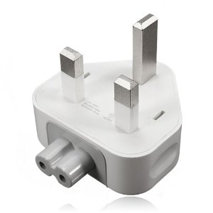

But there's one issue; when using the small UK travel adapter, rather than the power-brick's usual lead, I've noticed that it hasn't got any connection between the metal pin of the power-brick and the Earth pin of the travel adapter; unlike the lead which has a visible metal piece which links with the power-brick.
This causes the MacBook, only when I use the non-grounded travel adapter, to have a 'static feel' when I touch the metal case.
I was wondering what is causing this static build-up, and why apple wouldn't connect the travel adaptor to the Earth; I'm assuming it's not dangerous in any way.

The small piece doesn't have a ground so it can fold in. I don't understand why the extension cable does have a ground while the foldable plug does not. The old iBooks had extension cables without ground.
That makes sense for American chargers, although the UK ones don't fold in.

I'm confused... That plug has a grounding pin
Do you mean to say that the plug, although grounded, doesn't have a ground connection to the block?
It actually does. The silver metal round thing that is used to hold the plug in is also used for grounding. And if you look in the plug there is metal tabs to touch the round mount.

I think that it is intended to protect against the possibility of the mains cable being cut.
Also the UK sockets have a mechanical shield over the Live and Neutral which is moved by the longer ground pin being inserted, so the ground pin is needed even if not electrically connected.
Yes, this pin is needed regardless. Looking at the travel adapter compared to the AC cable, there's no connection to the Earth 'pin' thing on the block.
