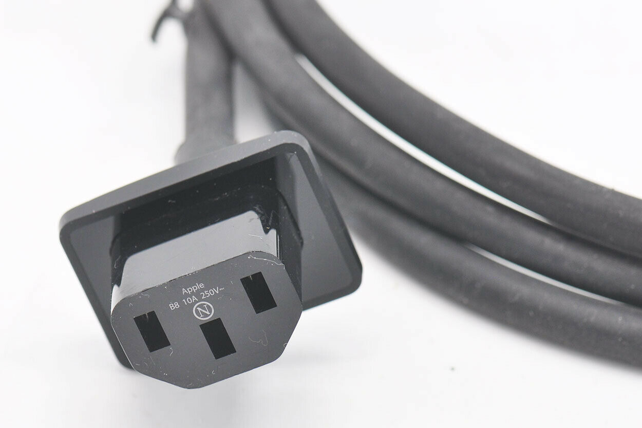

Found the above image from a reseller. Looks like a 10A fuse is required 🙂
Just looked and the cable for my old 1.1 Mac Pro (looks the same, only grey) has a 10A fuse in it (odd size for the UK). AFAIK that has a 980W power supply - I think the Trashcan is something like 450W continuous.

Just in case anyone is interested I bought another Mac Pro 2013 as the other one I sent back. This included a genuine Apple Power Cable and it is indeed a 10 amp fuse.
Hope that helps anyone else who buys a UK Mac Pro 2013 without a power cable.
