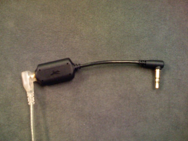

You might be aware that the MBP has some strange audio hisses and noises, particularly out of the headphone jack.
After losing my Shure e4c 's on my way home from China, I decided to get another pair of earbuds. I went with the Ultimate Ears super.fi 5 pro.
I popped the earbuds into the headphone jack on my 2.4 SR MBP and the hisses, pops, whines, etc. really came through. I wasn't surprised, headphones like these only exacerbate these types of problems.
Then I tried to plug the phones into my iPhone, they didn't fit - no surprise.
Then I took out the attenuator (picture attached) that came with the headphones. I plugged the earbuds into the attenuator and then the attenuator into the MBP - no more hisses or noises whatsoever. The volume is somewhat decreased (though it can still go loud enough to damage your hearing), and I can't detect any audio quality issues.
Then I plugged the attenuator into the iPhone and it fit there too - a nice bonus.
My Shures came with one of these things and I don't ever remember using it, but I might compare it with the UE's.
Just thought I'd share this with you guys in case anyone out there is bothered by the noises as much as I was.
Cheers

I've found the problem with this is that the attenuator clips certain levels (such as drums/cymbals) - noticeably affecting the quality of the music.
You might be right, but the hissing from our MBPs, in my opinion, is much worse than the negative effects of the attenuator.
Sounds like its doing its job 🙂
Id test with my pair, but when im on the go, i dont have my mbp, and when im at home, i generally connect via optical out to my z-5500's and the UE SFi 5 cord is too short to reach my elevator stand anyway.
Glad they included it, but I dont really pay attention to in flight movies.
Without the attenuator I can hear a terrible amount of "white noise" emanating from just about any speaker/headphone port. With it, everything sounds perfectly clear and the drums/cymbals are just as punchy as ever. I've used these for about two years now, and for the last 20 months or so I have never unplugged the attenuator once. Whatever non-existent bass loss (to me at least) there is, it's worth it.
