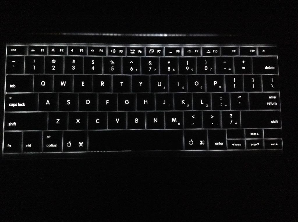

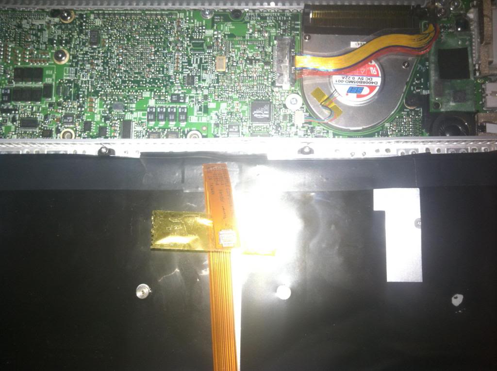

Keyboard Backlight Bleed
When I first got this thing, the backlight bleed was horrendous. I think someone had tried to take the keyboard out separately and didn't apply the black shield correctly over some gaps.
Solution: Electrical Tape
Just apply tape over the gaps in the casing.

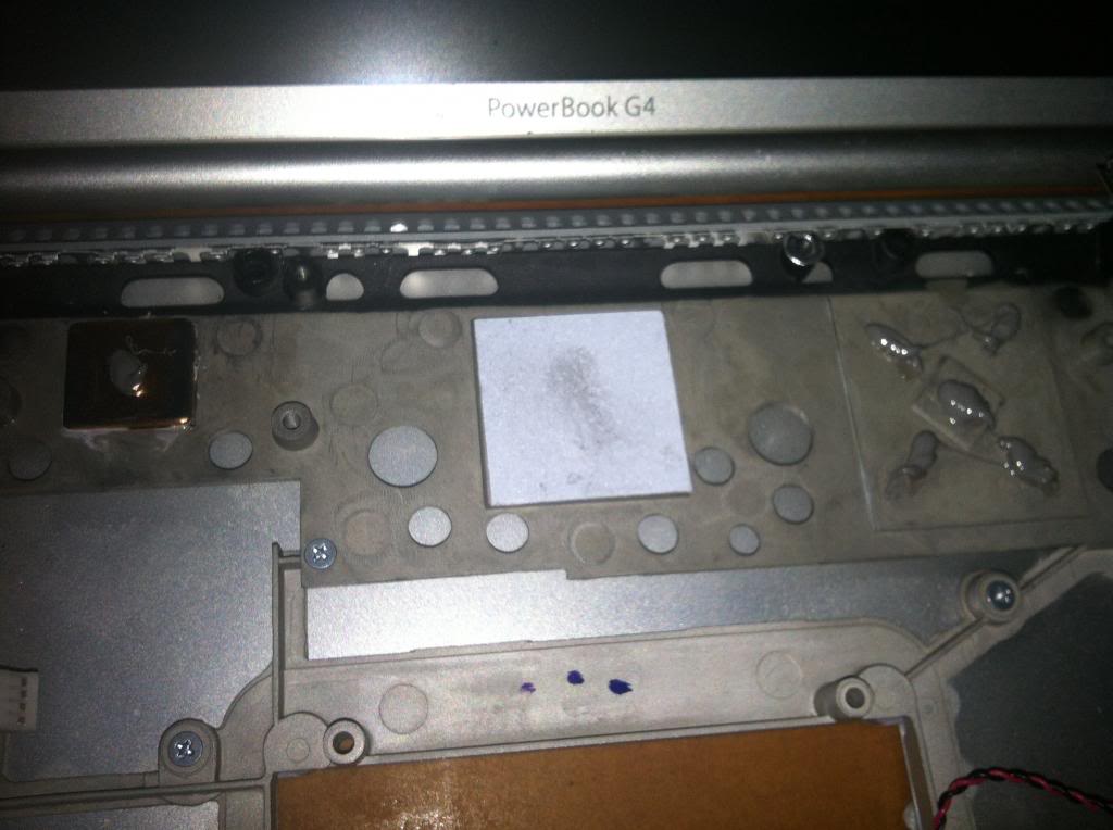

Hot Temperatures and Loud Fans
This one started when I was installing software, and thinking the speakers were making this humming sound. Turns out to be the fans spinning as fast as the little suckers could go, and you could nearly melt your legs off with the amount of heat coming off the bottom.
Solution: Thermal Paste
This stuff usually works wonders, and it did here too. I had one of those 20g sticks of Artic Silver 5. The stock thermal paste was pretty much baked into place, and not all that efficient for heat migrating to the heatsink. The GPU seemed to use gobs of it. WD40 takes the old stuff off like how a hot knife melts butter. Super smooth! Use a cloth to clean it up, paper towel/toilet paper make a mess.

WD40...I sure hope you really removed all the grease that it leaves behind! I fear that could easily destroy the CPU/GPU if you aren't extremely careful. Isopropyl 90%+ works better and is much safer IMO.🙂
I only use WD40 cause it's cool watching it liquify! I probably use it on more things than I should. I spent a good amount of time making sure the surfaces were dry, and I can assure you they are 🙂
