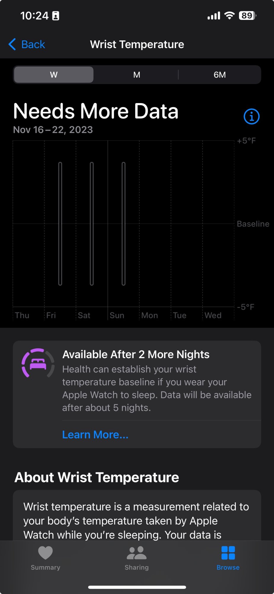

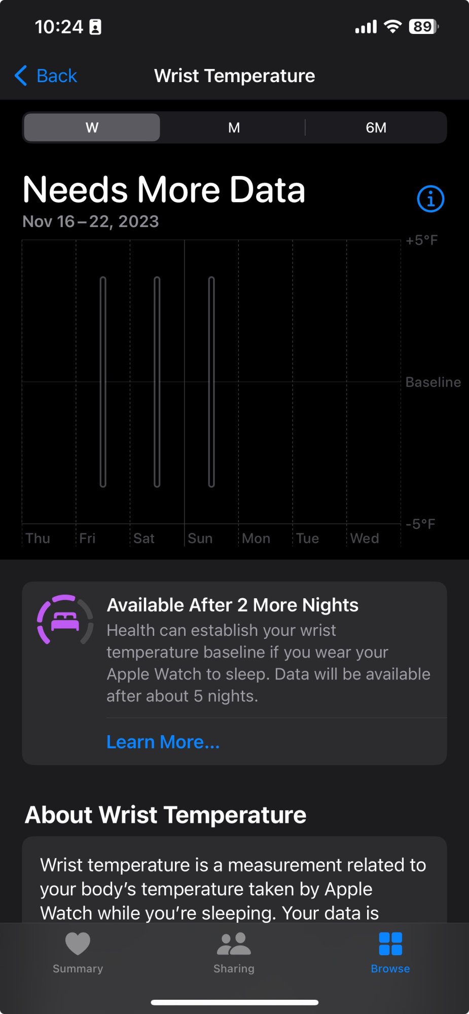

I seem to recall that the watch needs a week or so to set the baseline, in the wrist temp section of the Health app - are there no entries for the past 2 days?
Exactly - it was working then suddenly no data for the last 2 nights.
There are no entries for the last 2 days and Apple Watch is set as a data source.
I recall when I first got my Ultra that the summary screen showed like yours (x days remaining) but there was data recorded.
Do you have sleep data for those 2 days? Do you enable sleep tracking manually or per schedule? I’d also reboot the watch if you haven’t done that yet
@jz0309 I have my sleep schedule automatic and have sleep data for those days. I do have theater mode automatically turn on with sleep focus but I've done that forever and was getting wrist temperature the first few days, so don't think it's that.
I turned off wrist temperature and rebooted watch and phone, then turned it back on. Now I'll just see if I get a reading this evening. It's a bummer you can't just trigger a manual reading which would make this troubleshooting so much easier.

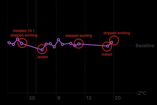

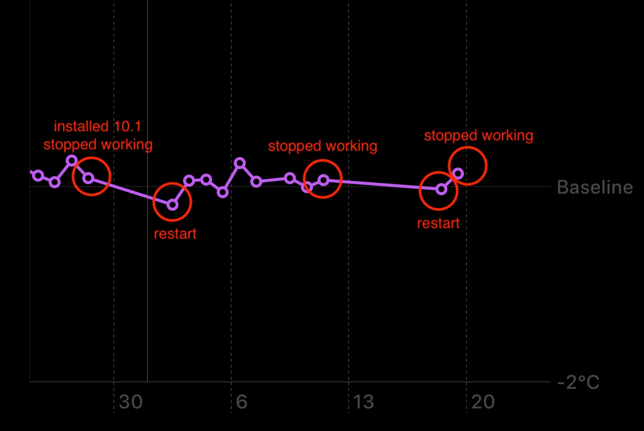

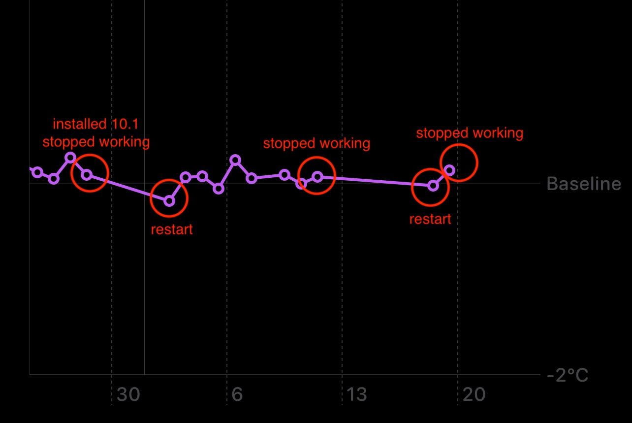

It's the same with my Ultra 1. Since watchOS 10.1 it just stopped working. Once i restart and turn off/on wrist temprature option in settings it starts tracking again, but then couple days later it stops working. Basically now have to restart the watch every day for it to work.

After the turn off, reboot both devices, and turn back on it was back working again. Just like what you're experiencing @imvaid .
