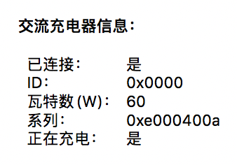

I have a first generation Ultrafine 5K display, the 16' MBP drives it perfectly except the charging power, most of the time this display charges MBP only at 60W, in this case battery drops when MBP opens some power consuming apps.
I suppose the old Ultrafine 5K should charge my MBP at 85W like it for older MBPs, is there any solution to adjust charging power?

Interesting, I just noticed my Ultrafine 5K is also charging my 16" at 60W, even though it charged my old 2016 MBP at 87W.
Can anyone verify that their Ultrafine is charging at 87 W according to "Apple Menu ➡ About This Mac... ➡ System Report ➡ Power" ?

I'm experiencing the exact same thing. The only solution seems to be to use the power brick, which is not a great solution IMHO.
