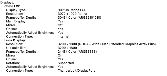

That doesn't sound like HiDPI. Can you take a screenshot of the System Profiler's Graphics/Displays section on the MBP with a Luna session to the iMac going on?
Here's a screen grab
Reactions: Amethyst1
Thanks a lot. 🙂 No HiDPI (if it were HiDPI it would say 6400×3600 for resolution). So they still haven't enabled HiDPI for iMacs as secondary displays yet, just for iPads (and maybe MacBooks?).
