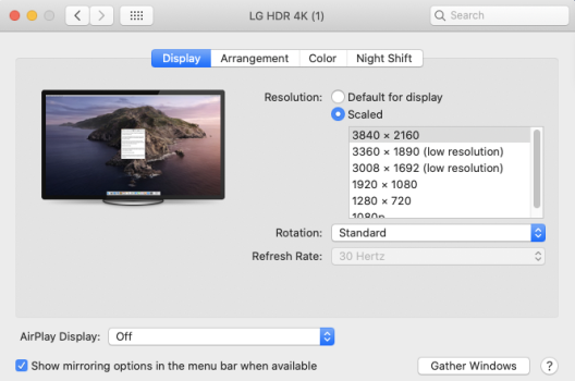

Confirming Amethyst findings but I also have additional resolutions options on LG4k monitor. The 4k and 1920x1080 look sharp, but for 4k everything is so tiny.1920x1080 looks good and would be an eye saver for somebody with eyesight issues. I will download BetterDisplay whether the 3008x1692 can be "cleaned out".

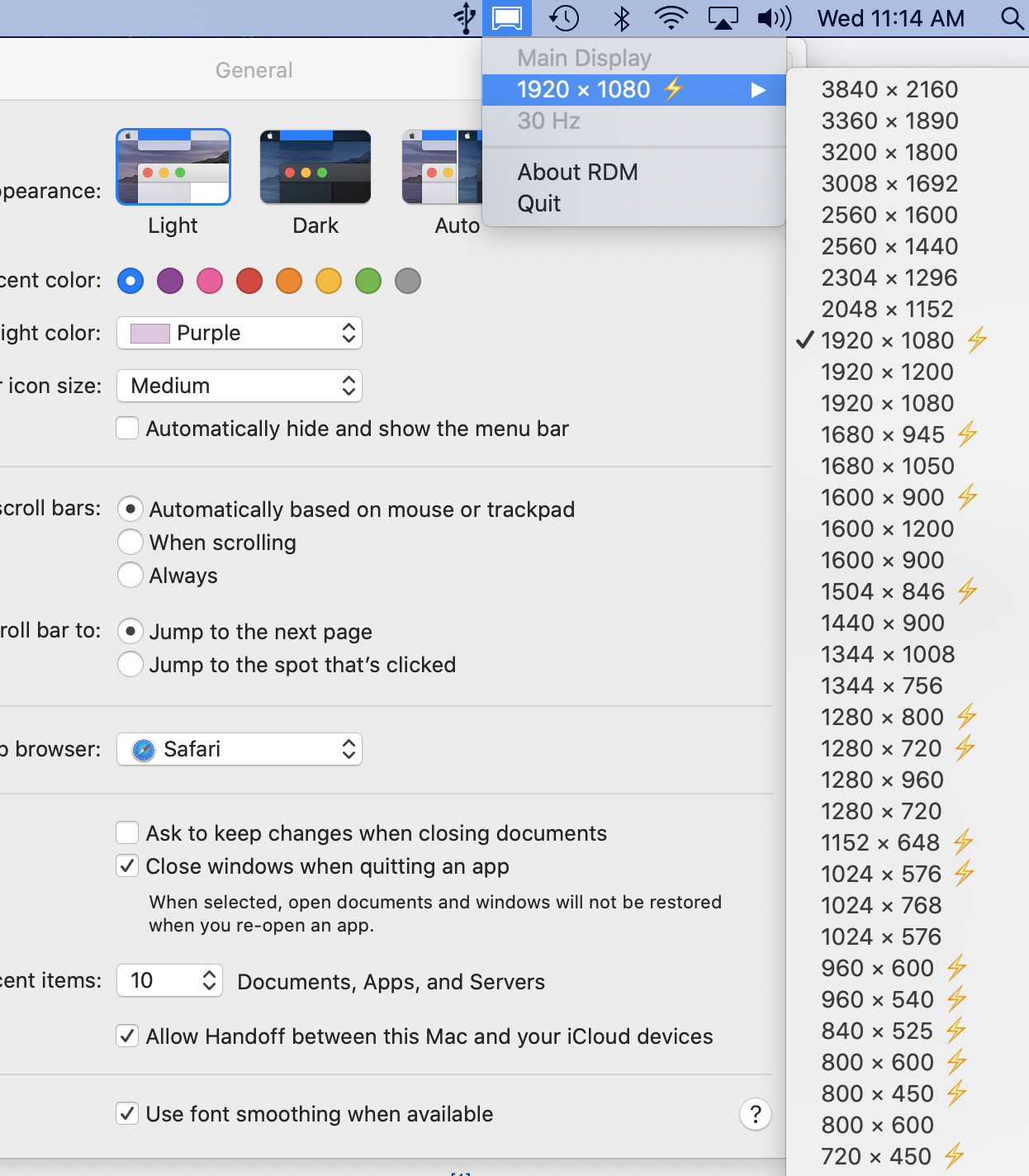

So BetterDisplay does not work on Catalina. I found an alternative program RDM which after installation (you need to allow install in Security settings) gives me more alternatives but still, the sharpest is the 1920x1080 and the 4k. Obviously RDM misses some features (Create custom HiDPI resolutions for real displays manually and redefine certain system display parameters) of BetterDisplay. My preferred resolution would be 2560x1440 if it would not be slightly fuzzy. I also tried SwitchResX with the same result, the last resolution with HiDPi sharp fonts is the 1920x1080.
You also can get some additional selection option when you hold the option-alt button while clicking on the "Scaled" button in Displays panel.
