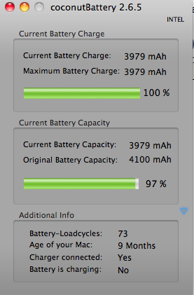

Had never heard of Coconut Battery, but downloaded it on your advice and the output is attached to this. Doesn't look to me as though there are any problems, at least using this program?

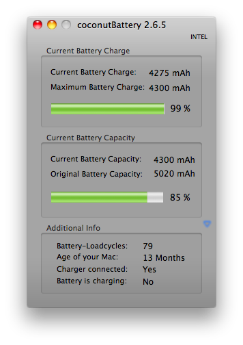

After 10 months, I can only get about 1:30 on mine. It's at 85% capacity right now and I've calibrated it religiously every month or so. Does this seem normal? What is Apple's warranty with batteries within the first year?
I have the same machine as you, 10 months old as well.....i have 84% capacity in coconut battery........but i have 321 loadcycles.....
