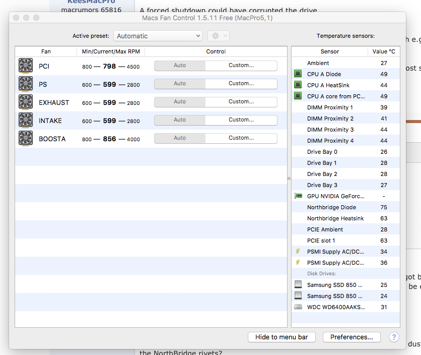

Heres a screenshot of my temps:
Temps look good, just wondering why the NB diode is at 75 Celsius (quite high for a single CPU).
I guess this screenshot was not made at idle (?) ...
Another thing is PCIe slot 1 is showing 63 celsius , what is so hot in slot 1 if I may ask?
Yes, it probably wasn't idle.
If I'm looking in the right place the PCI slot is showing NVIDIA GeForce GT 120
