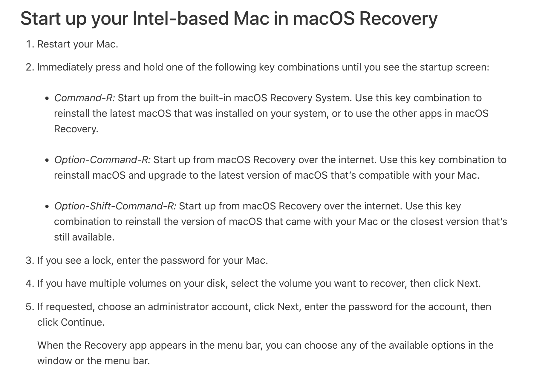

I went to the offfical Apple site - the screen shot is below. Item 3 says that if you see a lock you should enter your apple password.
OK, got that. I made sure my Mac password was correct by logging out and logging in again. No problem. However, the Lock Screen won't accept it. Can I boot to recovery via terminal?
OK and thanks. To set the firmware password requires starting from recovery. Back to square one! However, your link provides links to a whole set of options. I might just be able to do a reinstall of Sonoma. I'll work through the options and see what I can do.
