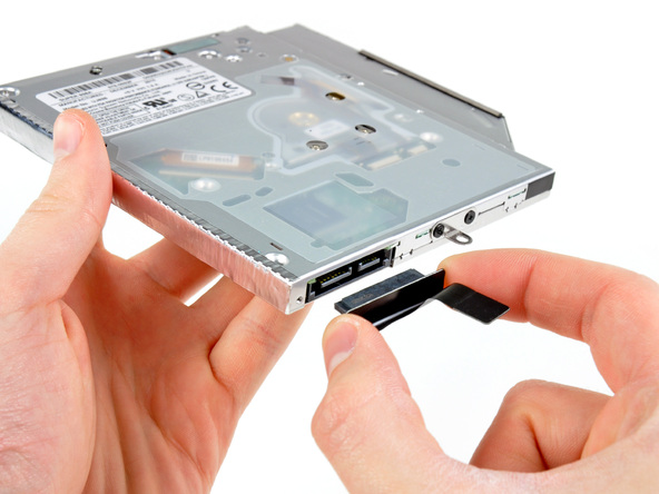

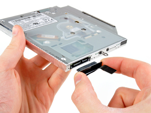

The SuperDrive is SATA connection, you can use that to eliminate the bad cable problem.

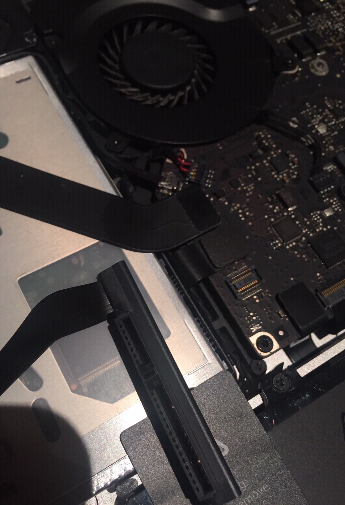

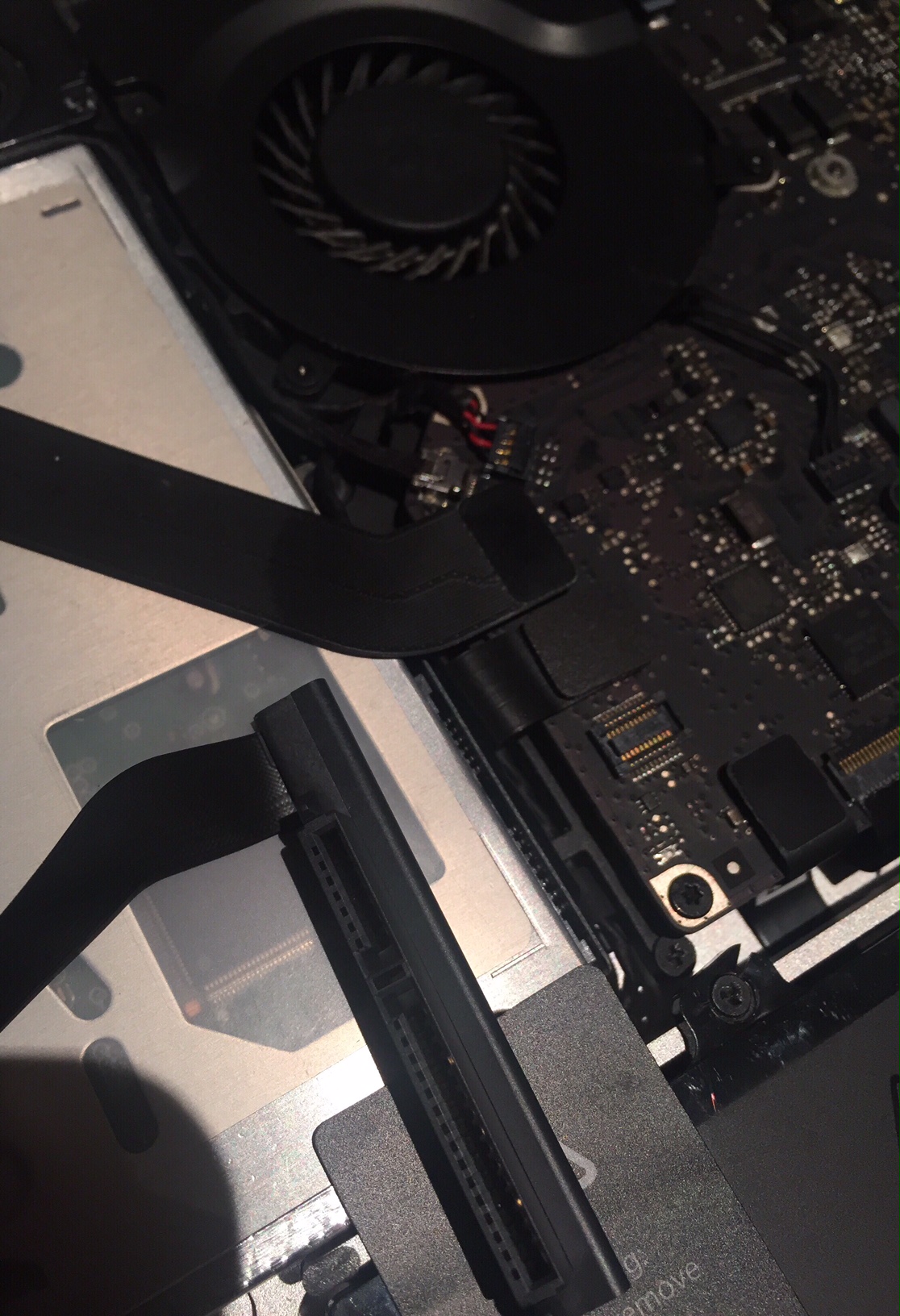

The SATA connection on the hard drive is much wider than the superdrive one. Yes my superdrive is like the one in your image but that connection wont fit the hard drive one as comparison in the pic;
On the left is the disconnected SATA hard drive cable whilst near it to the right is the smaller cable connection still plugged into the superdrive.
