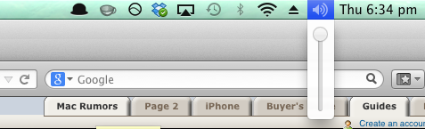

I had upgraded my mac mini from mountain lion to mavericks and now the volume can not be increased or decreased. It is permanently stuck at 100p.c.
I am attaching screenshots for your convenience.
Thanks a lot in advance for the help.

Check to make sure you aren't connected to any Air Play devices, I had an issue similar to that when restoring from a TimeMachine backup, volume worked before, didn't after. Also check in:
System Preferences>Sound, then make sure you have the internal speakers selected 🙂

You also can use the Sound icon in the Finder menu bar by holding down the command key+the sound icon in the Finder top menu. Now from there you can change input/output settings.
