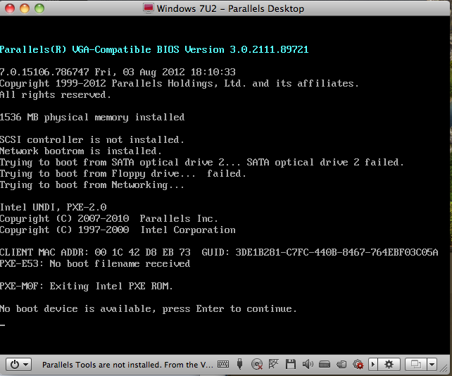

Now I get following messages:
Unable to connect Hard Disk 1
A file or device required for the operation of Hard Disk 1 does not exist or is used by another process, or you have no permission to access it. The virtual machine will continue running, but the device will be disconnected.
Unable to connect CD/DVD1
A file or device required for the operation of CD/DVD 1 does not exist or is used by another process, or you have no permission to access it. The virtual machine will continue running, but the device will be disconnected.
There is no operating system installed in this virtual machine. Please insert an operating system installation CD into the optical drive of your Mac and restart the virtual machine.
Which isn't true. There is a virtual windows *.pvm present. If I run the installation CD it will make a new installation not repair the one I want.
And ends with this pic.
