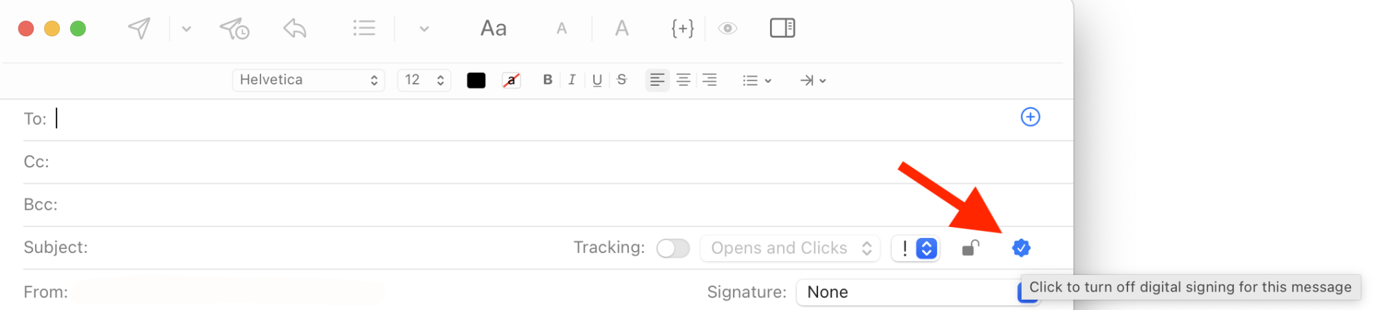

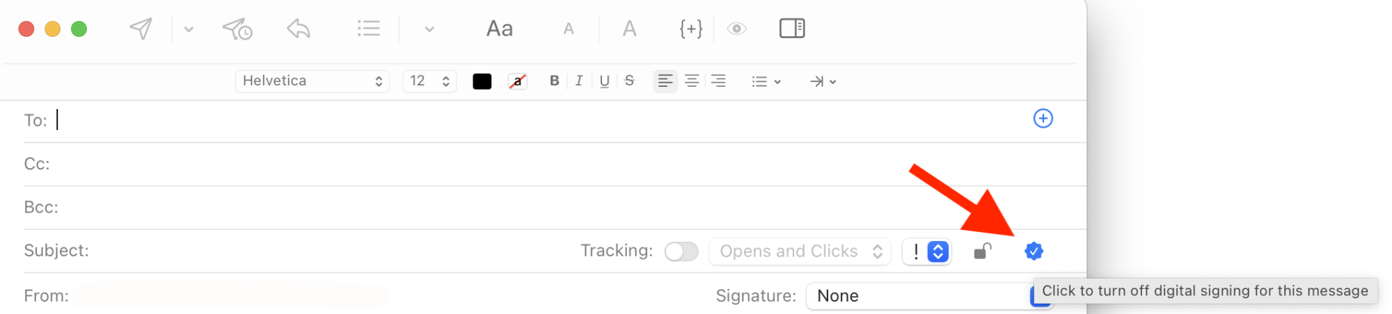

Old thread, but I encountered this issue and could not find a solution. After trying several things, I think I solved it by un-clicking the option to digitally sign email (screenshot below). It makes sense that this was probably accidentally clicked at some point. With digital signing unchecked, you do not need to delete the certificate.

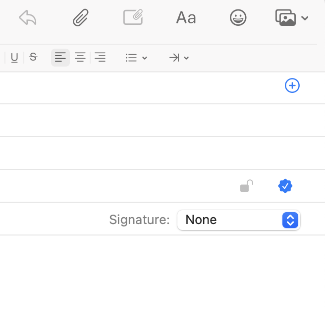

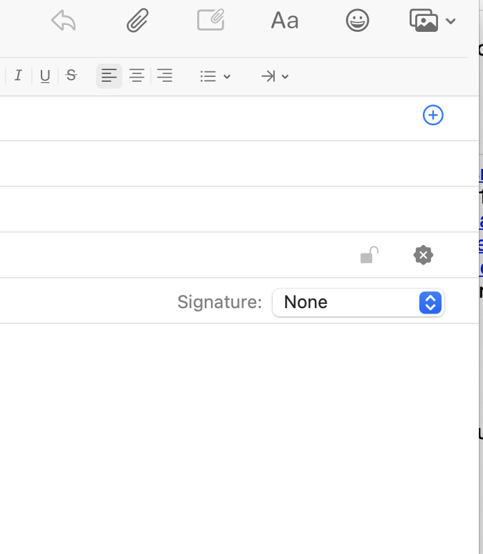

I think you solved it sparkhill - thank you! I was able to unlock/unembed the signature just by clicking on the blue checkmark. See screen shots - the one on the left is what I unchecked and it finally removed the encrypted signature certificate:

2025 and this is still a problem, and the only solution I've found is the one referenced above: Uncheck "digitally sign" on the email compose screen.
