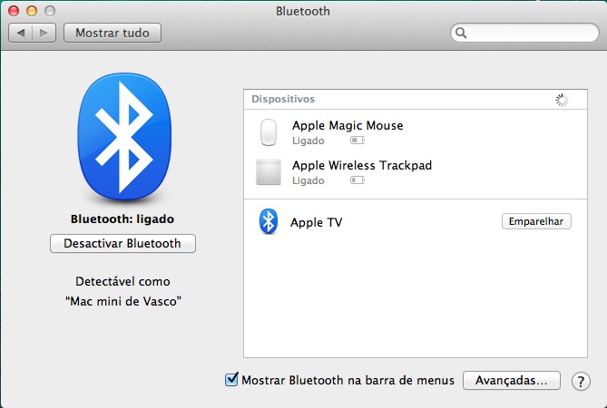

I' afraid that doesn't help. That windows shows only Magic Mouse and Wireless Trackpad - both connected. Also no gear wheel or + or - signs at the bottom, as I have seen elsewhere, perhaps this OSX v. 10.9.1 has that modified.
Thank you, anyway.
I may add that the keyboard works fine with my Apple TV, so nothing is wrong with it. The Mac mini BT unit must be fine too, otherwise the mouse and trackpad wouldn't work. I think this has to do with some sw file that is not OK.

Then, with a glimpse of inspiration, I unplugged the Apple TV that stays in another room. Immediately the Mac mini connected itself to the kb! And then I started the Apple TV again, with no further interference with the kb.
It seems that for some reason the kb locked itself to the other device and then becomes undetectable by the Mac mini. The strange thing is that the kb was not paired with the ATV as shown on the image above.
