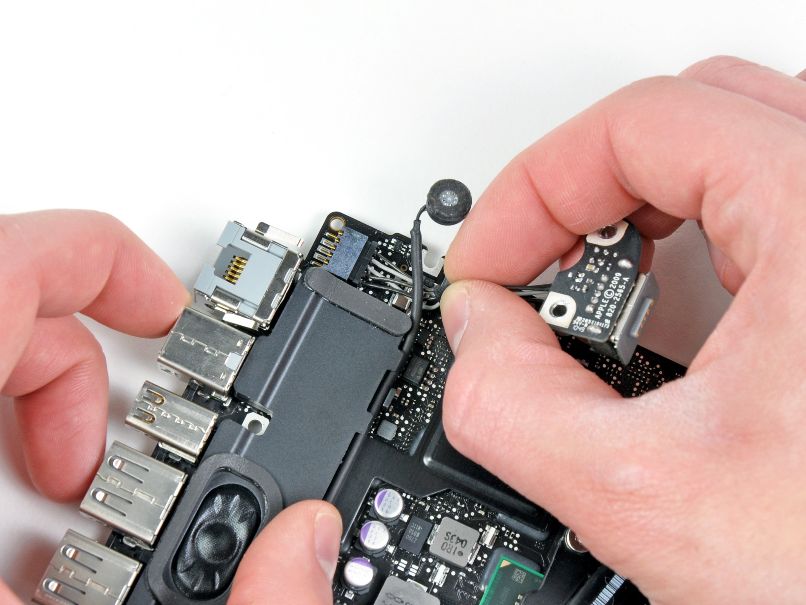

You can take the 2011's DC-in board and plug it into the faster 2012 board. You just pull the new one out and put the old one in.
iFixit has some really good guides on how to do it.

Be sure to check that little DC-in board, as that is fairly common failure point, and then you don't have to give up the USB 3.0 ports (the 2011 logic board does not have USB 3.0)

You should be able to take the working DC-in from the 2011 logic board and swap it out for the DC-in board on the 2012 board. That way you can keep the faster system and USB 3 support.
