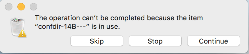

I was attempting to Compile Kodi on OS X 10.11 with Xcode 7 (previously had Xcode 6 installed) fowling this guide (Specifically post #63)
http://forum.kodi.tv/showthread.php?tid=229468&pid=2032543#pid2032543
I made it to "make -j2 -C target/binary-addons" before it failed. I deleted the Kodi folder Created and now I am getting this error when emptying the trash with a folder named "confider-14B---"
screen-shot-2015-10-02-at-3-29-15-pm-png.588894
sudo commands are not emptying the trash, i have tried every way of emptying the trash but I cannot get this folder to budge. Also my kernel_task in activity monitor is running very hard.
has anyone experienced this or have a solution. I will link to the helpful threads I have found on this but i can resolve it.
http://apple.stackexchange.com/questions/200364/cannot-cleanup-os-x-trash
https://trac.macports.org/ticket/28654?version=2
Thanks in advance for any help.

Restart your computer with the option 'reopen windows when logging back in' disabled.
Then try empty the Trash again. Should work.

I've tried that a Few times, here is what I'm getting. FYI file path "1/" (in my attached output) was me renaming folders before i realized it was looping creation.
I can say that I am way more than a general mac user (and very prone to search for things on the internet first), so any of the regular troubleshooting tips are not working. I'm trying to get an out of the norm solution.
Code:
Joes-MacBook-Pro:~ Keating$ sudo rm -rf ~/.Trash/*
Password:
rm: /Users/Keating/.Trash/1/1/1/1/1/1/1/1/1/1/1/1/1/1/1/1/1/1/1/1/1/1/1/1/1/1/1/1/1/1/1/1/1/1/1/1/1/1/1/1/1/1/1/1/1/1/1/1/1/1/1/1/1/1/1/1/1/1/1/1/1/1/1/1/1/1/1/1/1/1/1/1/1/1/1/1/1/1/1/1/1/1/1/1/1/1/1/1/1/1/1/1/1/1/1/1/1/1/1/1/1/1/1/1/1/1/1/1/1/1/1/1/1/1/1/1/1/1/1/1/1/1/1/1/1/1/confdir-14B---/confdir-14B---/confdir-14B---/confdir-14B---/confdir-14B---/confdir-14B---/confdir-14B---/confdir-14B---/confdir-14B---/confdir-14B---/confdir-14B---/confdir-14B---/confdir-14B---/confdir-14B---/confdir-14B---/confdir-14B---/confdir-14B---/confdir-14B---/confdir-14B---/confdir-14B---/confdir-14B---/confdir-14B---/confdir-14B---/confdir-14B---/confdir-14B---/confdir-14B---/confdir-14B---/confdir-14B---/confdir-14B---/confdir-14B---/confdir-14B---/confdir-14B---/confdir-14B---/confdir-14B---/confdir-14B---/confdir-14B---/confdir-14B---/confdir-14B---/confdir-14B---/confdir-14B---/confdir-14B---/confdir-14B---/confdir-14B---/confdir-14B---/confdir-14B---/confdir-14B---/confdir-14B---/confdir-14B---/confdir-14B---/confdir-14B---/confdir-14B---/confdir-14B---/confdir-14B---/confdir-14B---/confdir-14B---/confdir-14B---/confdir-14B---/confdir-14B---/confdir-14B---/confdir-14B---/confdir-14B---/confdir-14B---/confdir-14B---/confdir-14B---/confdir-14B---/confdir-14B---/confdir-14B---/confdir-14B---/confdir-14B---/confdir-14B---/confdir-14B---/confdir-14B---/confdir-14B---/confdir-14B---/confdir-14B---/confdir-14B---/confdir-14B---/confdir-14B---/confdir-14B---/confdir-14B---/confdir-14B---/confdir-14B---/confdir-14B---/confdir-14B---/confdir-14B---/confdir-14B---/confdir-14B---/confdir-14B---/confdir-14B---/confdir-14B---/confdir-14B---/confdir-14B---/confdir-14B---/confdir-14B---/confdir-14B---/confdir-14B---/confdir-14B---/confdir-14B---/confdir-14B---/confdir-14B---/confdir-14B---/confdir-14B---/confdir-14B---/confdir-14B---: Bad address

rm: /Users/Keating/.Trash/1: Directory not empty
I also tried creating a user account and logging of my main account and emptying my main account trash from the new account. No Luck
I Just wanted to update this, and say there wasn't a solution that i could find so i did i fresh in stall of El Capitan.
I have same issue... hoping there is another solution rather than reinstall.
I notice can move the folder around... wonder if moving to another user and then removing the profile.. gonna try that.
Edit - didn't work
I found solution in case anyone is still interested:
I moved the Kodi folder out of trash into folder of hard drive and then in terminal I navigated to the folder where the repeating folders started...
~/Kodi/tools/depends/native/tar-native/X86_65-osx-native
make superuser:
sudo su
In there is folder:
confidir-148B---
so I rename to a:
mv confdir-148B--- a
Then here is the command which will fix:
while [ true ]; do mv a/confdir-14B--- b; rm -r a; mv b/confdir-14B--- a; rm -r b; done
After a while it will stop or error with dir not found so press CTRL-C
Folders should be all gone, so now you can remove the entire Kodi folder and trash it etc.
It keeps moving the tree up and deleting the leftover single folder and alternating between a and b
I found this on another site:http://superuser.com/questions/9303...now-cant-delete-file-using-either-trash-or-rm
I think the problem is that the entire path is too large for OSX filesystem commands to work on.
Solved it for me, hope it helps.
