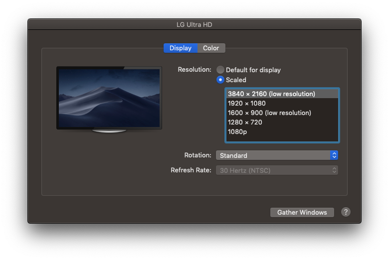

Hello,
I have been unable to achieve 4K resolution @ 60 Hz. I'm unable to get 60 Hertz refresh rate. The option is greyed out at 30 Hertz. I have the following hardware:
I have been searching the internet for hours looking for answers and I can't seem to figure out what's wrong. I even read a few Amazon reviews on the cable I'm using and people seem to have 4K @ 60Hz on this same monitor.
Under System Preferences > Display, this is what I get:
What's the problem here? Is it the monitor or the cable I'm using?

That's what I'm leaning towards as well. I just don't understand what exactly am I doing wrong.
Some (not all) USB-c to displayport cables that work with 2016 MBPs WILL NOT WORK with the 2017/18 MBPs.
The only way to know is to read the user reviews (and also product ad should specifically state that it's good with the 2017/18 MBPs).
