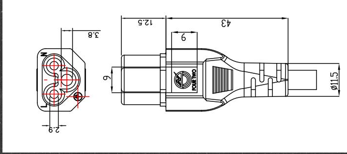

The fit of the "Mickey Mouse" side of the power cord on this dock suck, it does not fit tightly and slips out easily. Same for the supplied Thunderbolt 4 cable. I have had loose fit issues with the USB "C" cable too. I have ordered replacements for both. This is not the first time I have run into this problem with the IEC 60320-C5 (Mickey Mouse) plug it is not a good design.

Yes the new power cord fixed the problem. As I said I have run into this problem with this design before. A good quality aftermarket power cord always fixes the problem. The Anker thunderbolt cable also fixed the loose fitting OWC cable.
