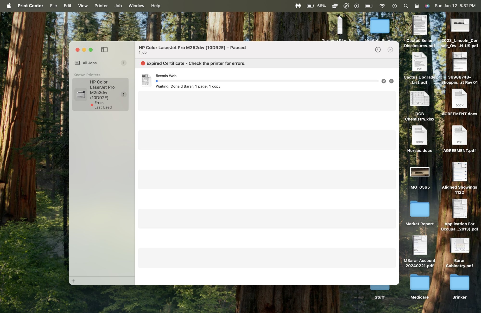

Hi Xray:
Here's a screenshot of the Expired Certificate error.
Don

How is this printer connected?
USB, ethernet, wifi ??
Can you go into Keychain Access, find the HP certificate, and "trust it"?
Reactions: xraydoc
Hi F, I am using WiFi. Keychain access is not the way to go. However, I was able from the Settings/Printer and create a certificate. This did work. Don
