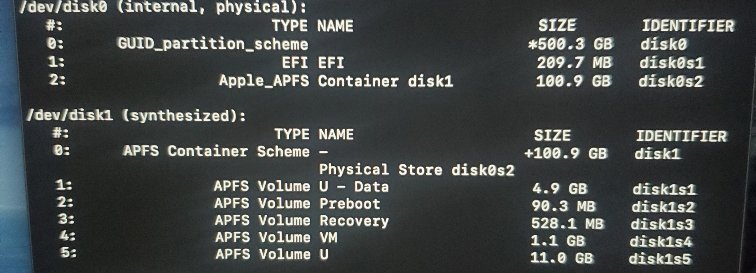

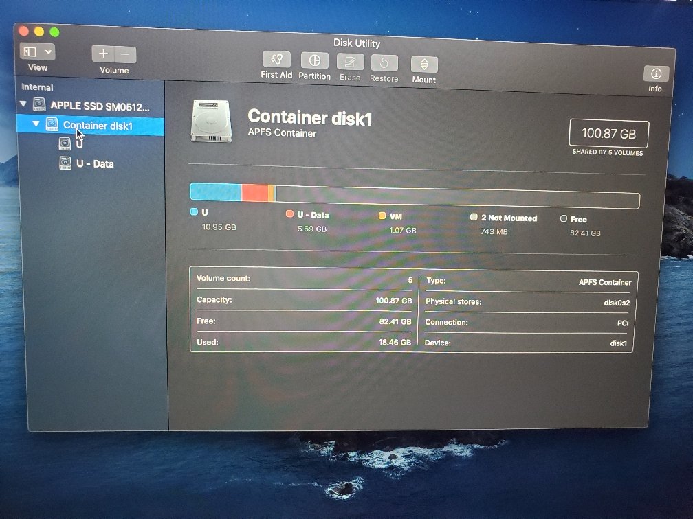

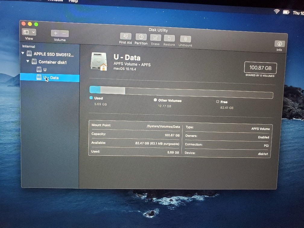

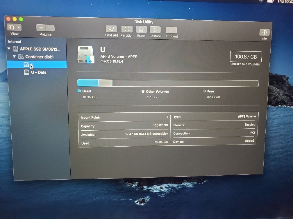

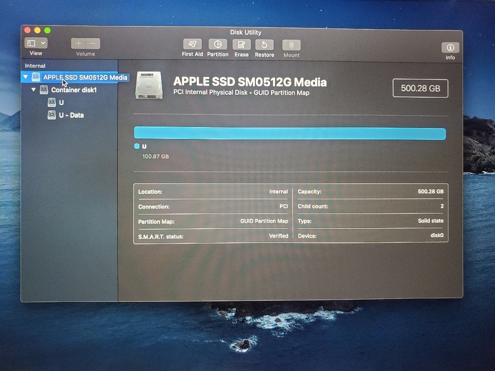

Hi
After removing boot camp using disk utility. Now I can't recuperate the space that window was using.
I will really appreciate any assistance.
Thanks in advance!

Thanks I will try that out also. But the situation is that I don't have a partition that says Boot camp or which I will erase it.
Also How do I get to the disk utility? I use comand, option and R and is stay stuck
