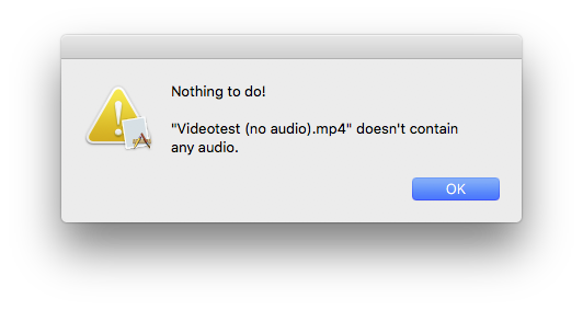

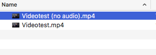

What do I need to change in order to make "theName" display the target file (i.e. "Videotest (no audio).mp4") and include the file-extension? I tried replacing "theName" with "theFile" but it didn't work.
Applying the Service to an non-audio video file displays the filename correctly:
AppleScript:
display dialog "Nothing to do!" & return & return & "\"" & theFile & "\" doesn't contain any audio." with icon caution buttons {"OK"} default button "OK"
Add (no audio).mp4\" to the message

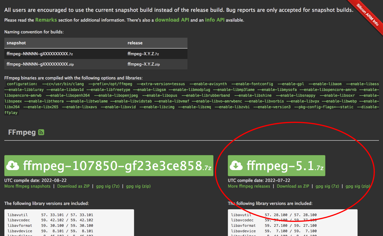

The ffmpeg page is a little confusing when you'd expect a single "download" button instead of all those options.
Is it the one on the upper right side (circled in red)?
That's the one (the zip file) I've downloaded now (and replaced the old ffmpeg binary with). But I'm getting the exact same error as before, so the problem must be something else.

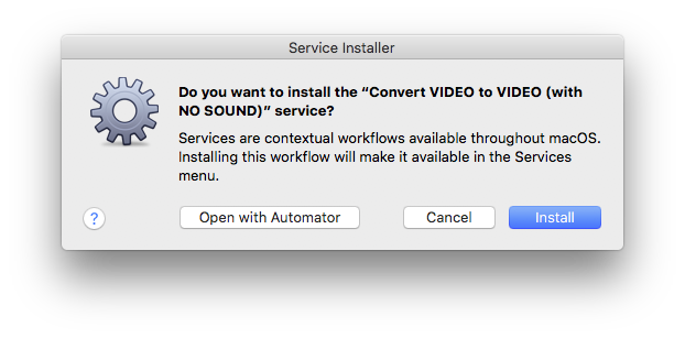

To any new user wondering how to install this OSX Service:
1)
download the attached .ZIP file, then double-click on your Mac to decompress it.
2) now double-click the Services file.You'll be asked if you want to install it. Click the "Install" button:

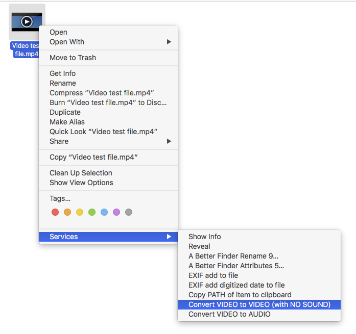

3) The Service is now ready for use. Right-click on the video file (or select several files first, then right-click on those) and select the Service for converting this/these videos to audio-free videos.
