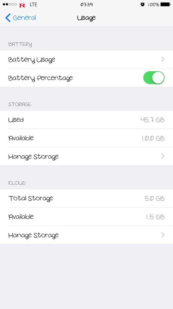

Did you try to go under general > usage
Did you try to go under general > usage Image
Yes I did. It did not work for me 🙁
