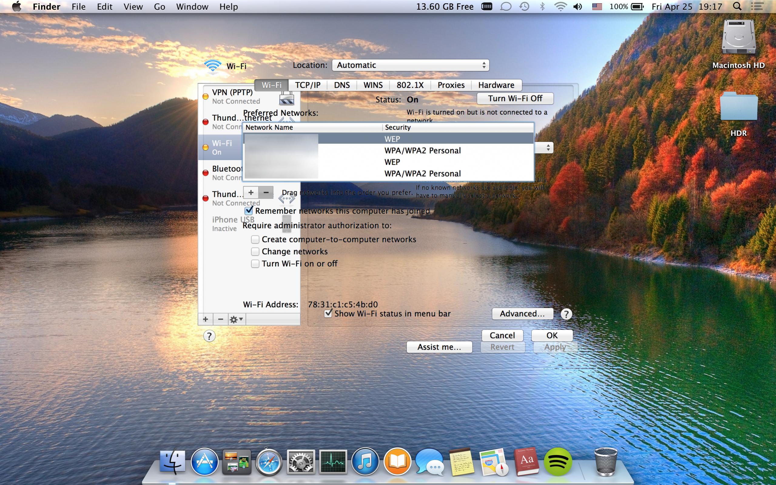

Good day,
Recently, I was trying to remove a wi-fi network from my system preferences as the network had transitioned to WPA2 (from WEP), so I had to remove the old network as it had the same SSID as the new one.
When I clicked on the - button to remove it, the cursor beachballed when it was inside the window. When outside of the window, it reverted back to a normal cursor.
After 5 minutes of waiting, I forced-quit it and this is what happened.
This glitch only appears in that space and not in other spaces.
The only way to get rid of this glitch is to logout and login.
It happens on my two 13" rMBPs and also my 15" rMBP.

Good day,

The problem is that whenever I try to remove a wifi network, the preference panel freezes up (but the windows still looks intact). So, when I force quit System Preferences, I get the result in the screenshot of the original post (where it's half transparent).

The problem happens with wi-fi turned off on the Mac. The Mac isn't connected to Ethernet either.
Steps 2 and 3 were carried out and produced the same results :/
I'm starting to think it's a Mavericks bug.
Thank you for your advice anyway 🙂
