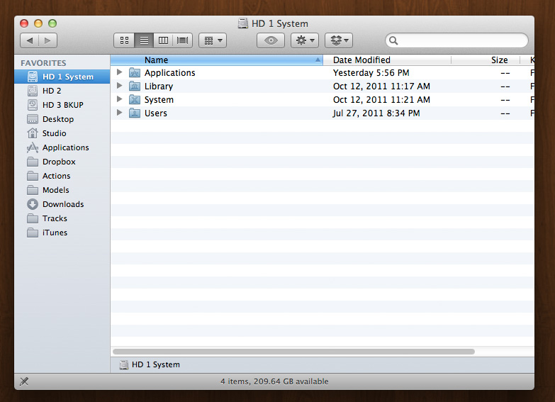

What the heck, can you post a screenshot of your Finder window.

Here's a screenshot. Thanks for the help btw.
