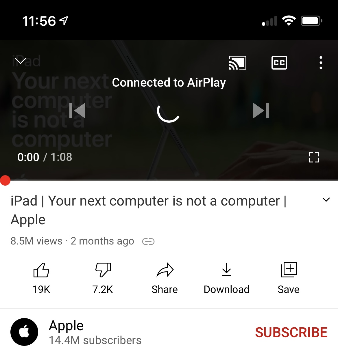

On the YouTube app on iPhone/iPad, the video won't play in either full screen or non-full screen mode. As soon as I click on a video, I get this:
And the loading ring just goes on forever on both the phone and ATV - video never plays. As soon as I stop mirroring my iPhone, the video instantly plays on my iPhone.
