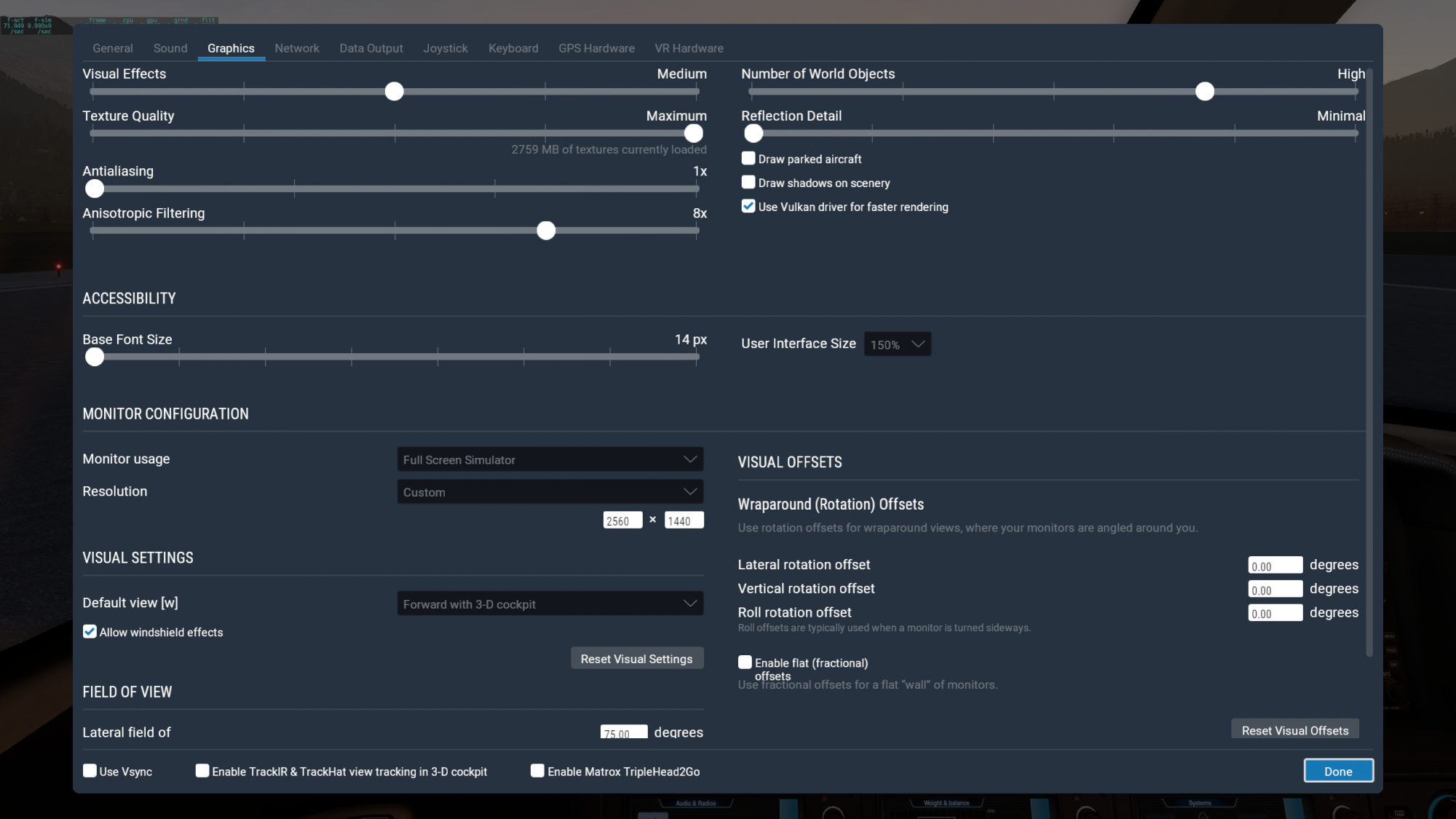

I recommend the following:
1) Use my graphics settings (see attached screenshot). This disables effects which are very computionally intensive but bring little image quality.
2) If it your GPU still gets too hot, use Macs Fan Control to enable a custom fan setting while playing X-Plane (for example, reaching the fan its maximum if the GPU reaches 80 degrees Celsius).
3) If the GPU is still getting too hot, then install X-Plane in Windows and use one of the available tools to limit the frame rate to a certain amount that is lower then the frame rate your are getting without vsync (for example, 30 FPS is very popular in the flight sim community).

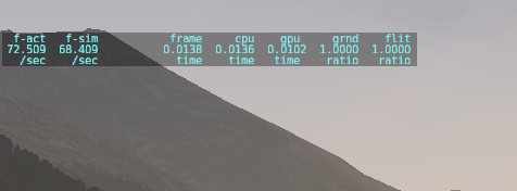

Additional infos:
A) Please look at the small screenshot with the numbers. If the "gpu time" is higher than the "cpu time", then the CPU must wait for the GPU - and vice versa. Thus, if your GPU is overheating, change X-Plane's graphics settings so that the GPU must wait for the CPU. This way, it has some time to "cool off" during every frame.
B) I may be wrong, it seems to me that the vsync option is not working correctly in X-Plane 11.50 right now. For example, when I am in a situation where I get 73 FPS without vsync and then enable vsync, I suddenly get about 37 FPS instead of the expected 60 FPS.
I am using TG Pro to monitor my temperature. My settings are similar to yours. TG pro does have the ability to set up a custom fan curve and I can target which temperature reading to activate the fan. I think that will be the next step. Also I think I need to learn more about the cup & gpu time data in the frame rate window. Thanks again fo the help.
