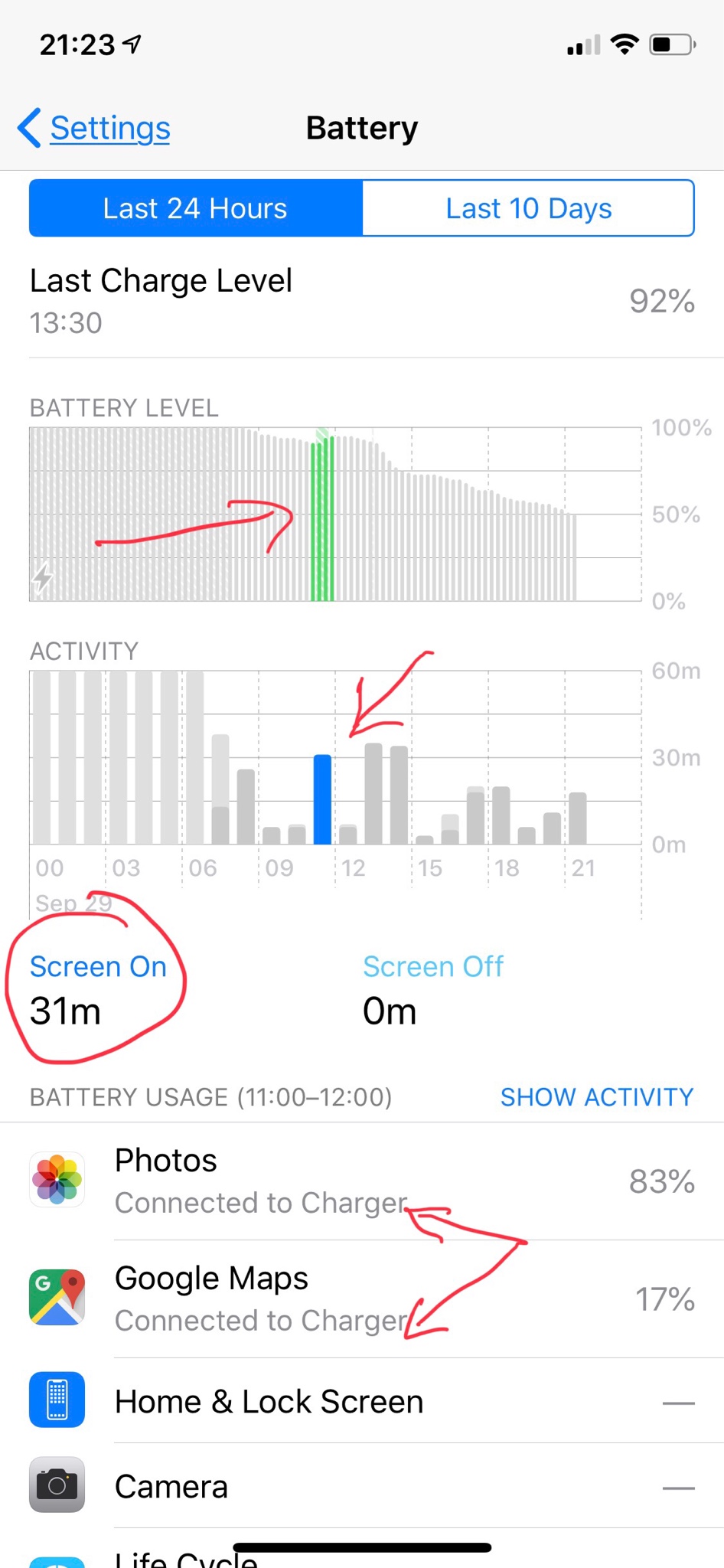

This first screenshot gives you the detail for the last 24hrs (no matter how many times you charge it).
The red box shows when it was last charged and to what percentage. As you can see i had mine on charge today which i will explain later.
The highlighted Activity and Screen On/Off times show the total of the last 24hrs, again regardless of times on charge in that period.
The next screenshot shows the apps that used the most battery in that 24hr period, again regardless of charging.
This third screenshot shows how to see, hour by hour, how to understand the statistics.
Click on one of the bars highlighted by the arrow and you will see the following:
What the charge level was (No.1)
The total amount of activity as a bar chart. This is both screen on and background activity with the screen off. Dark blue is screen on light blue is screen off. (No.2)
The total time the screen was on (No.3)
The total time the screen was off but the phone was doing something. (No.4)
Also a list of apps in order of what was using the battery the most being at the top.
In this next screenshot you can see indicated by the top arrow that the phone was on charge. If you look closely you can see there are two sets of bars. One for the battery charge (which is going up) and another showing how long it was on charge for. In this case circa 30mins of the 1hr time block.
The second arrow shows the screen on/off time as normal and the amount is also circled.
Th final two arrows at the bottom will also tell you that although in use they were connected to a charger whilst being used.

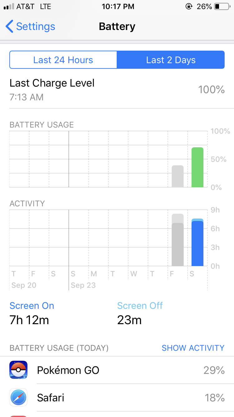

[doublepost=1538277611][/doublepost]Pro-tip:
Since I didn’t use my phone after midnight and started using my phone after I unplugged it at 7:13am, clicking this graph shows me my total usage for the day since I was last fully charged also. Why is this so hard for you guys to understand? (Also I use a smart battery case on my 7,this is why I have such awesome screen on time)

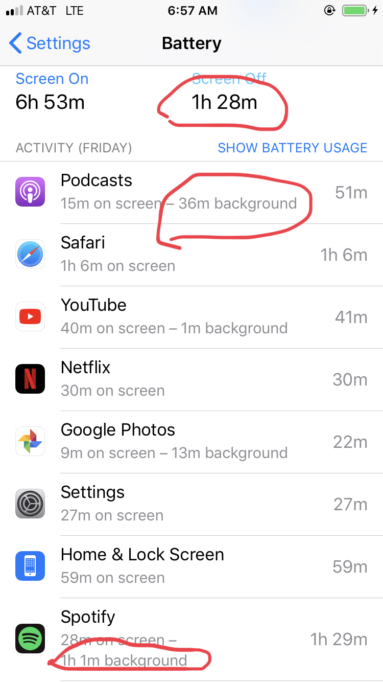

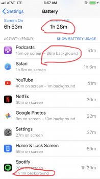

My screen off never shows any time. Always shows 0 minutes
Mine works but it doesn’t start counting up until about 5 minutes or so after the screen has been off with podcasts anyways. If I’m using Spotify it works pretty good but it’s not perfect. The times never add up correctly and maybe there is a reason for this but I feel like it’s a bug. Apple really needs to put out an explainer.
