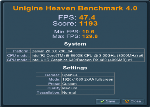

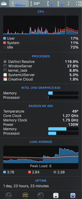

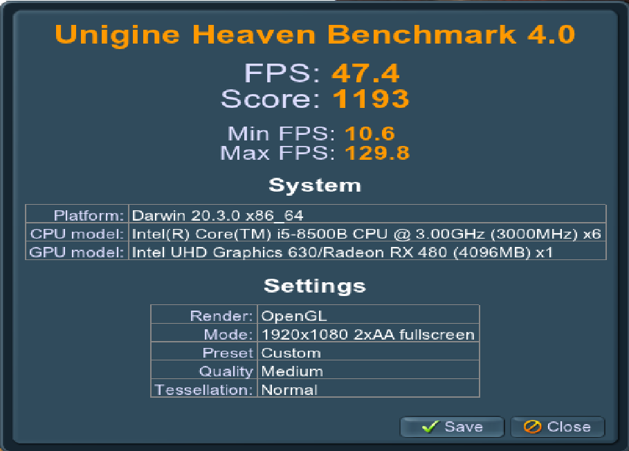

Monitor is a 3440x1440 100Hz ultrawide, connected directly to the eGPU DisplayPort. I've attached screenshots of iStat while exporting in DaVinci and the results of a Unigine Heaven benchmark (medium, 1920x1080).

In that case, sorry but I think the performance you're seeing is just what you can get out of this GPU in an eGPU set then. It'd likely perform way better than the Intel iGPU for actively working with complex timelines and compositing, but yeah as for export times dedicated hardware blocks always outperform software based rendering. You can try and check the GPU setting under Final Cut's Playback preferences, but it should already be using the eGPU.
That's what I was starting to think but it looks like you've confirmed it. Many thanks for your help.

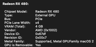

Another question for @casperes1996 (sorry to bother you again!) - in System Info I'm only seeing x4 for the PCIe Lane Width. Is this normal/correct? I've seen YouTube videos where people have all 16 lanes showing.

To be honest; I don't know. Thunderbolt itself is only 4 lanes of PCIe effectively so it seems sensible for it to report x4. However, it could also report it based on the PCIe chassis/box it's connected to externally, which could have an x16 link itself even though Thunderbolt itself would only carry a connection of ~x4

You got a eGPU, but in the end you are only comparing the GPU hardware encoder performance. The truth is that Intel quick sync is better, so if the hardware encoder is the bottleneck (because your timeline is not gpu heavy, you got almost no filter and the gpu has got nothing to do) it will be faster to just use the built-in Intel gpu.
Thunderbolt is usually x4. If a GPU connected via Thunderbolt is showing x16 then it means there's a PCIe switch between the GPU and the Thunderbolt controller - the switch maybe a part of the GPU (I don't know if such GPUs exist - the Vega II Duo for the MacPro7,1 has a separate switch with two separate GPUs connected to it - but that's not what I'm talking about).
System Information.app doesn't show PCIe hierarchy so it doesn't show switches. You need ioreg or pciutils do show that info.
Youtubers are often not knowledgeable.
16 lane slot is the mechanical connector. 4 lanes is the electrical connection.
