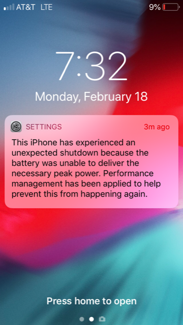

This evening, I took a couple of pictures and was texting them to 2 friends when I had an unexpected shutdown. The battery was at 17% when that happened. On boot up, I got the attached message and the battery read 9%.
My understanding was that these shutdowns happen if the battery is not healthy. However, in my case the battery capacity is at 95% of original.
Why was the battery unable to deliver peak power?
Thanks.

Battery capacity is different from battery health. iOS only displays the capacity.
Factors affecting overall battery health includes battery impedance. A battery's impedance increases with chemical age and also increases in cold temperatures.
Your battery may be able to hold 95% of original capacity, but if it can't deliver that energy quickly enough due to increased impedance, battery health is poor.

Weak batteries are even weaker in cold weather - is the likely explanation.
Reactions: MEJHarrison
OP, it could have been a one time thing, or it could be a symptom of an unhealthy battery. Seeing as how your battery health is at 95%, it's probably a one time thing. Snapping pictures and texting them shouldn't result in a peak power draw.
I would go ahead and turn off the power management feature and see if it happens again. If it does, especially if you're not doing much, then it's probably a dying battery.
NOTE - I wouldn't put too much stock in what iOS reports as Battery Health. If you have a Mac handy, use Coconut Battery to check on the battery health.

Most people here seem to confuse battery capacity with overall battery health. It is incorrect to believe that a battery with 95% capacity means the phone shouldn't shut down. How much capacity a battery can hold has nothing to do with how quickly that charge can be released.
Apple says "This performance management works by looking at a combination of the device temperature, battery state of charge, and battery impedance." Apple didn't leave out battery capacity in that sentence by mistake. Battery capacity and battery impedance are entirely different things - but both play a role in battery health.
The Battery Health section is broken down into 2 sections:
  1. Maximum Capacity
  2. Peak Performance Capability
Apple provides a percentage for Maximum Capacity. But for Peak Performance Capability, Apple looks at a combination of temperature, battery state of charge, battery impedance, and gives a pass/fail.
Looking at battery capacity alone is like looking at blood pressure alone to determine health.

Without getting technical, a battery at 95% of max capacity is generally not that old. As batteries get older, they tend to lose max capacity as well as losing the ability to deliver max power. It's right there in your link.
The OP has a battery at 95% capacity. The phone itself is only 6 months old (from time of purchase). He was down to 17% battery charge. He wasn't doing anything that typically requires peak power. Yet his phone shut off. Yes, the charge was at 17%, so that could be a contributing factor. But the other stuff would generally point to a different culprit, especially since this was the first time he had a shutdown.
So my advice would be to turn the throttling off and go about his business. If it happens again, then he's probably got a bad battery. If not, then it could have just been a one-time glitch.

Based on my experience, I would suggest a new battery, particularly if the device wasn't operating under extreme temperatures when the shut down occurred. I've replaced two devices with 93-95% capacity batteries in December under the $29 program. Shut downs occurred in the 10-15% range outdoors. Both of them already batteries replaced earlier in the year in Feb-Mar.
For the OP, I think it comes down to whether they can live with a device that could shut down at 17%.

I checked with Apple. They said replacement phones only have a 90-day warranty. They ran diagnostics remotely and said the battery is bad but it will cost me $49 to replace it. Maybe I should just get an 8 and help them out.
If it were me, I would just get the $49 replacement. Maybe if you express some mild aggravation or lightly complain, they'll replace the battery for free. Yeah, I see that the replacement warranty is only 90 days, but you've only had it for 6 months. The battery shouldn't die that quickly.
Incidentally, do you have the diagnosis from Apple, other than them saying "the battery is bad"? Is there a number or percentage? Back in the day (and maybe they still do), they would say that you could expect the battery to retain at least 80% max charge at around 300 charging cycles, or something like that.
No additional info. They just said I need to take it in to confirm the diagnosis and possibly get it replaced (if it is confirmed). I think the battery is failing because the phone probably sat with no charge for a very long time before it sold (given to me).
