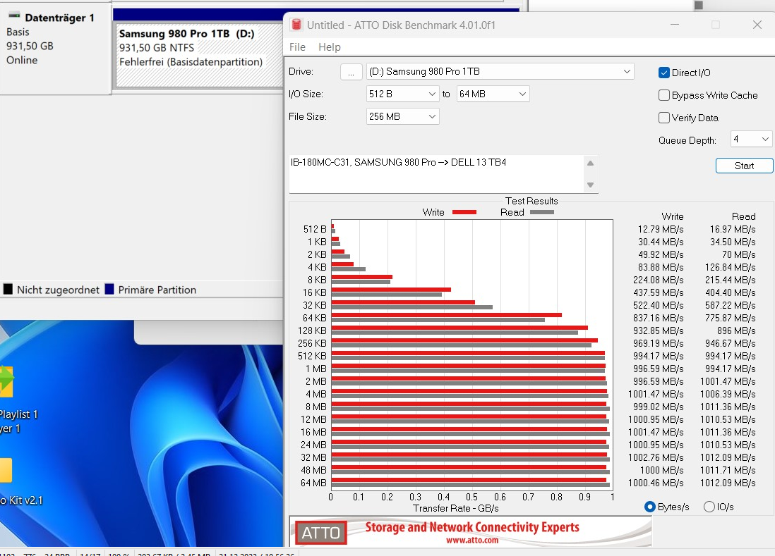

RaidSonic sent this to prove that 10 Gbps can be achieved through this cable:
So I don't doubt that. But I am annoyed because this should not be supported through a 3.0 cable!
They argue that another cable would just confuse consumers. No, it would not. I want cable markings to reflect the supported USB spec. I would have expected a 3.1 cable for a device that connects to a host's USB 3.2 (Gen 2) port (either of type C or type A).
