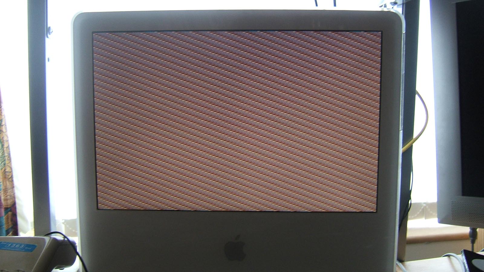

I've got a G5 iMac which is 5 years old now, it's got 2Gb RAM and 75Gb HD
In the past couple of weeks it really slowed down and then it started having panic attacks and random freezes. It also crashed with a what appeared to be a wierd zig-zag pattern [see attached jpeg - this happens even when the log-inscreen is on]

The logic board is bad. More specifically, the graphics chip. Those models are notorious this issue. Sorry mang.
its a g5 iMac, so its the bad caps showing up now
and yes the 1.6/1.8/2.0 g5 iMac's had been notorious for bad caps
on the 1.9 and 2.1 models apple had i guess partly solved the problem in 2006 about at the same time as with the eMac 1.42 the problem was solved too
and for same reasons apple had a repair exchange scheme for the bad caps , but that ran out long time ago and apple did make it quiet easy for owners back then just bring in the iMac and get a new board fitted ...if only the owners would have known about the scheme ..but most didn't know about and apple didn't tell everybody ....
sorry mate , but there is hope if you can solder then you can solve the problem for about £20 by changing all the bad caps inside or for a bit more you can get it done from your local radio/tv repair shop , apple is not a option because they would exchange the board which cost you more then a new iMac
