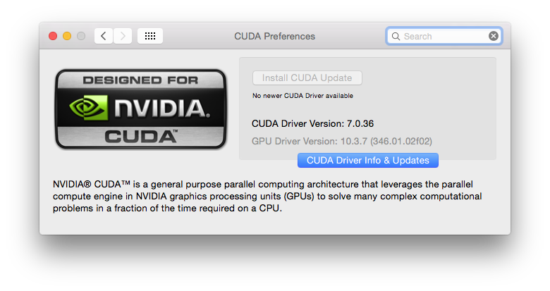

When you open and check the Cuda Preference Pane, what does it show?
Lou

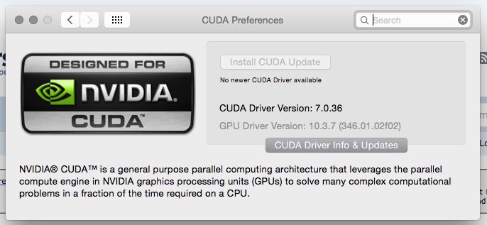

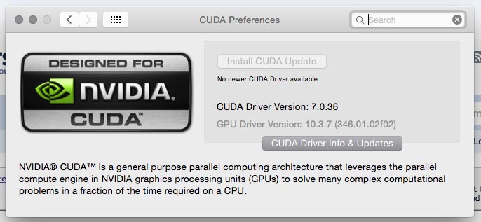

It shows the same info as your screenshot. Here's mine:
