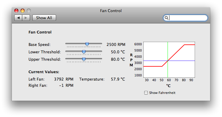

I got the unibody macbook the day after it came out. (the 2.0 ghz model) The fans were dead silent when I first got it unless they were really going then you could hear them. Now they always make a purring sound and at times will go into a crazy noise and it only gets worse until I shut down because I don't let it last too long because it is a horrid sound and I don't want anything getting damaged. It's coming from the left fan. I then installed fan control just to see what it was saying about my fans, I start it up and then I see this.
The right fan is going at -1 rpm? So I have no idea whats going on with that. Even just this morning right after it booted up, I had nothing running but I started up photobooth because I heard the fans getting louder and it ended in this...

well the fan thats making the noise is definitely spinning. you can hear it come to an abrupt stop when it actually does stop...the right fan on the other hand i doubt is even spinning at all
Macbooks only have one fan, the macbook pro is the one that has 2. Fan control is reporting a value of -1 for the right fan because there's no right fan in the macbook.
ok thanks for that info. still have my problem though, was just throwing in the info on the right fan just in case it had to do with anything. at least i only have to worry about 1 fan now though!
is this a known problem my right fan is also at -1 ? i remember when i opened up my macbook to install the ram i only saw 1 fan in there to being with? is there 2 fans in there?
If I were you I would take it to the genius bar. Sounds like a defective fan, and if so Apple would be your best bet. If they decide that there's no problem then kindly ask to talk to the manager, and if that doesnt work then call applecare; usually they are more willing to work with you.
LOL I thought this was a MacBook Pro! LMAO. That -1 reading is correct and is there for the lack of a second fan. But there still is a problem with the one fan you have though.
