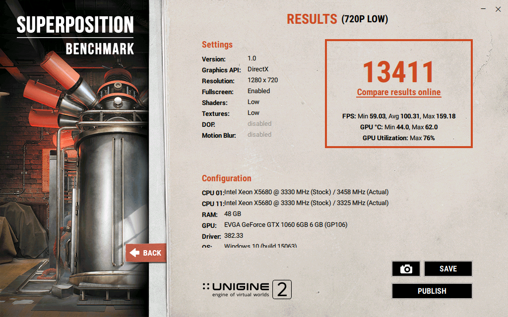

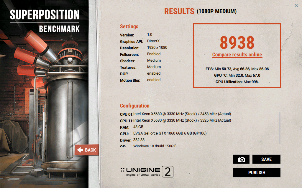

Thanks, I did not pay attention to that item. It was not at 100% for his high settings run either.
But the maxed out superposition benchmark shows 99% gpu use, that's why I asked him for gaming benchmarks that we could compare to the newest cpu like i7-6700 or i7-7700.
Under 2k resolution, it just don't need that much of GPU power. But the score is at the end of the bar. When you see the benchmark running, it's as smooth as silk.
We should ask someone with Mac Pro 6.1 to do the benchmark. Judging by the spread of fps is not realistic if the deviation of the complexisty of scenes are just like that. I haven't seen any Mac Pro 6.1 reported their Unigene 2 benchmark here. I'd like to see their default benchmark, 4K optimized, 8K optimized, and also VRs.
You can definitely not able to compare a crazy 4.5Ghz Hacintosh to this in 2k resolution.

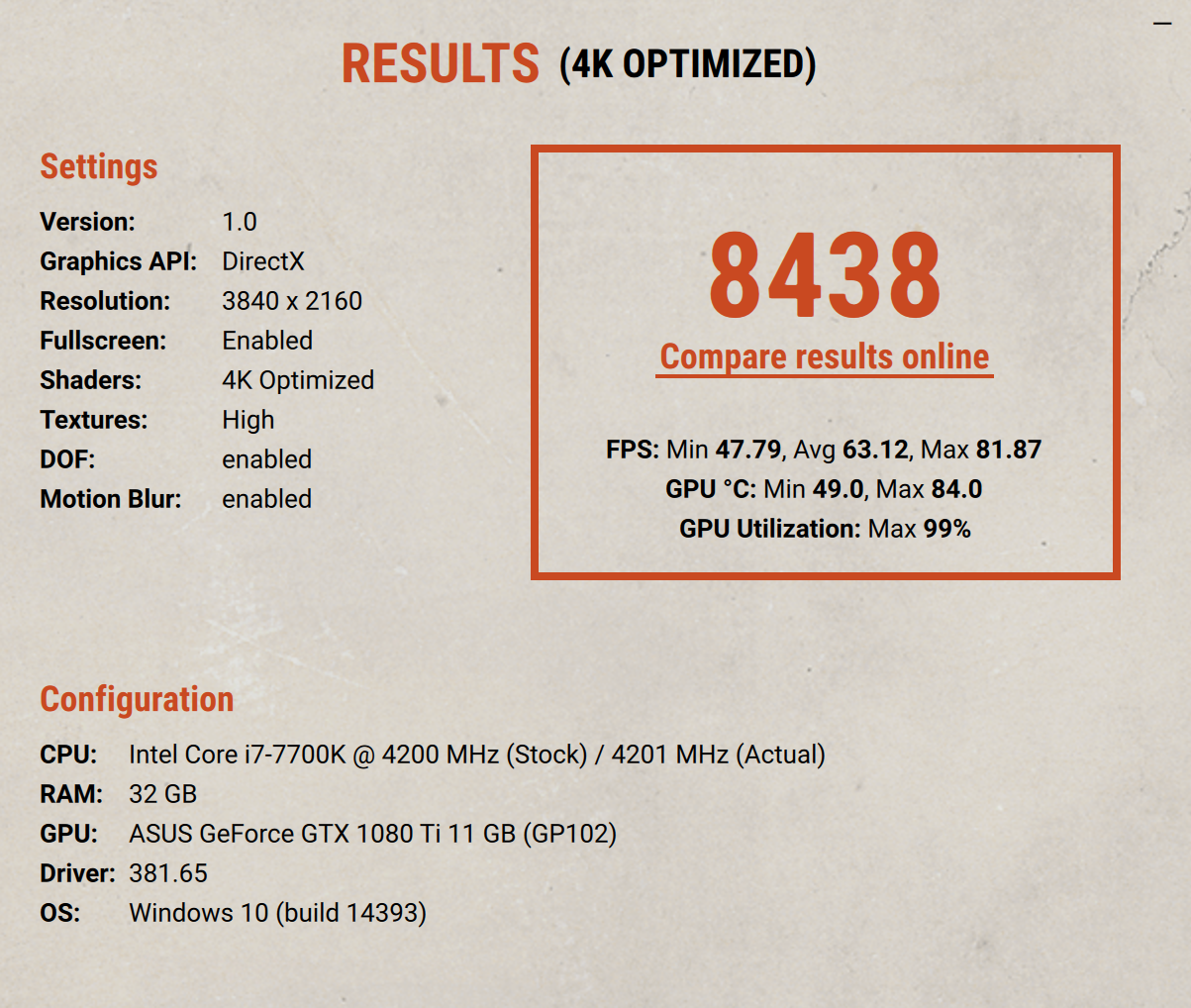

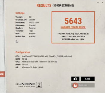

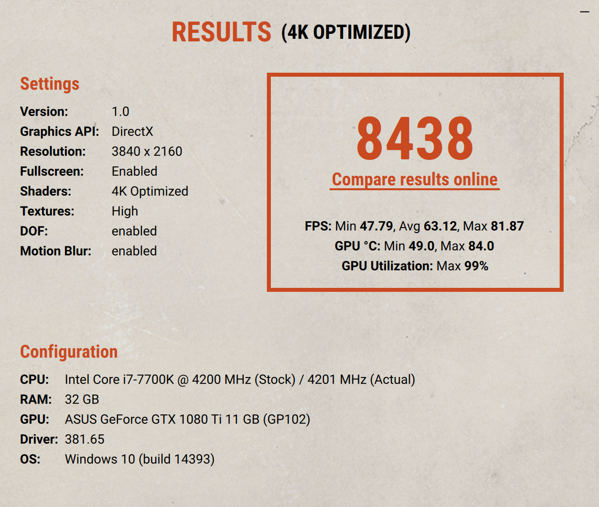

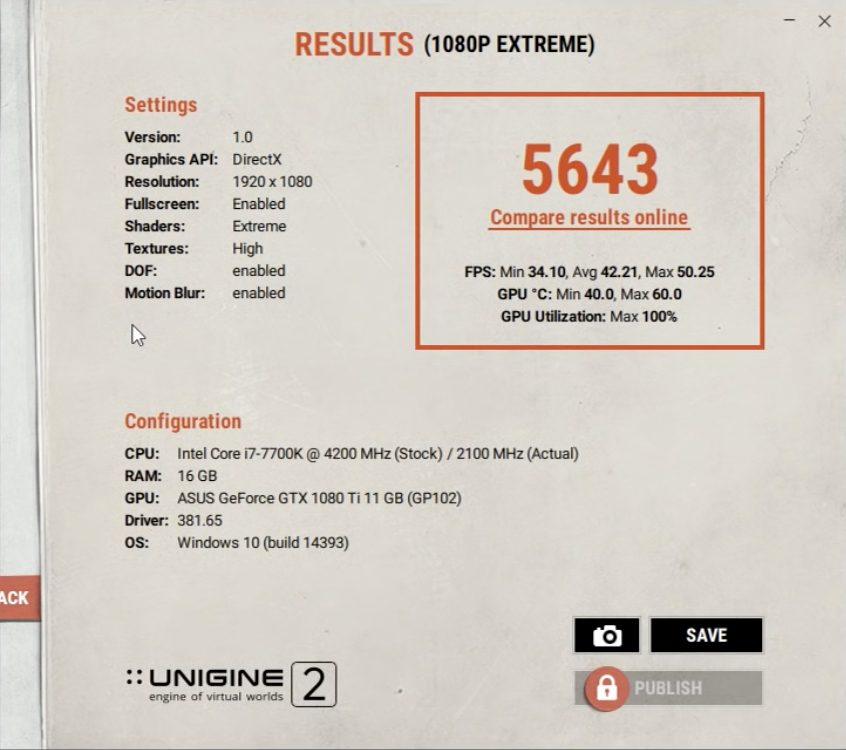

Yes, that's maybe it, but I compared your cmp score with i7-7700k and your results were higher (I think because of the gpu power: Titan X (Pascal) vs gtx 1080.
So in this test you were not bottlenecked at all and your gpu usage were on 99% 🙂
I wonder how much difference would it be in games but who cares if you can get strong and stable 60fps+ in 1080p.
I'm only afraid that our cpu won't be as strong as I think and there will be dips under the 60 fps...

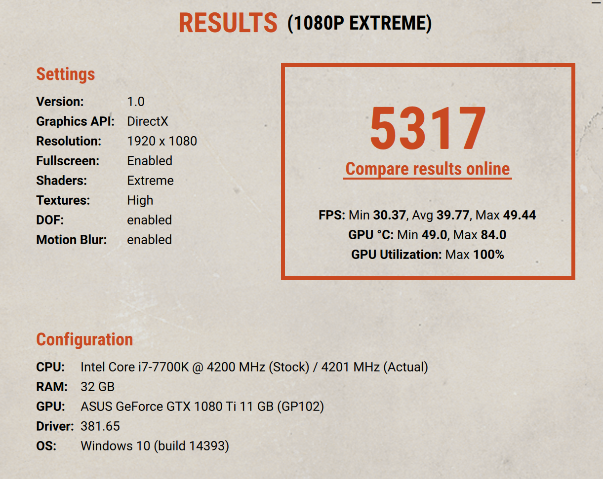

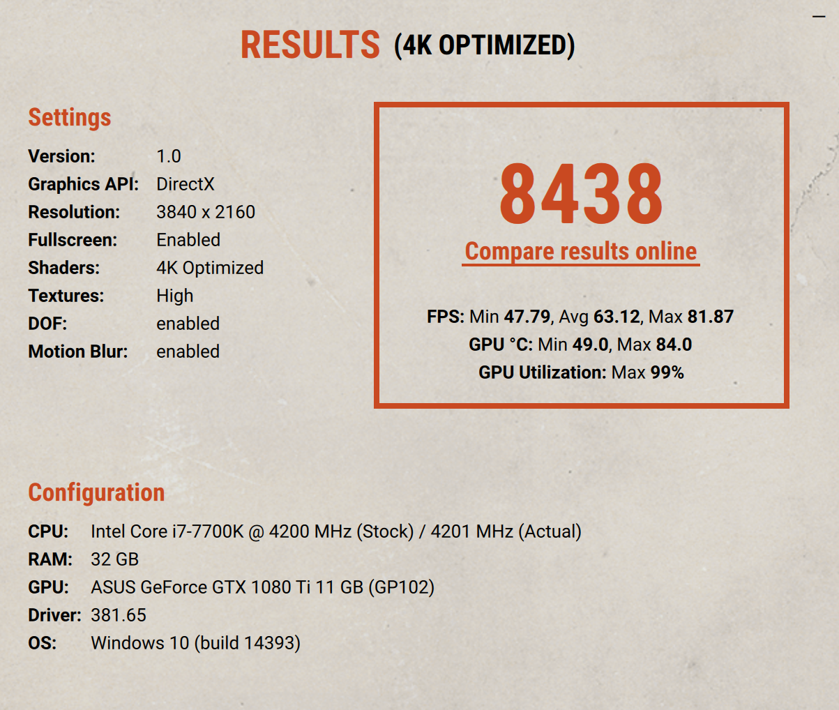

For comparison my 7700K:

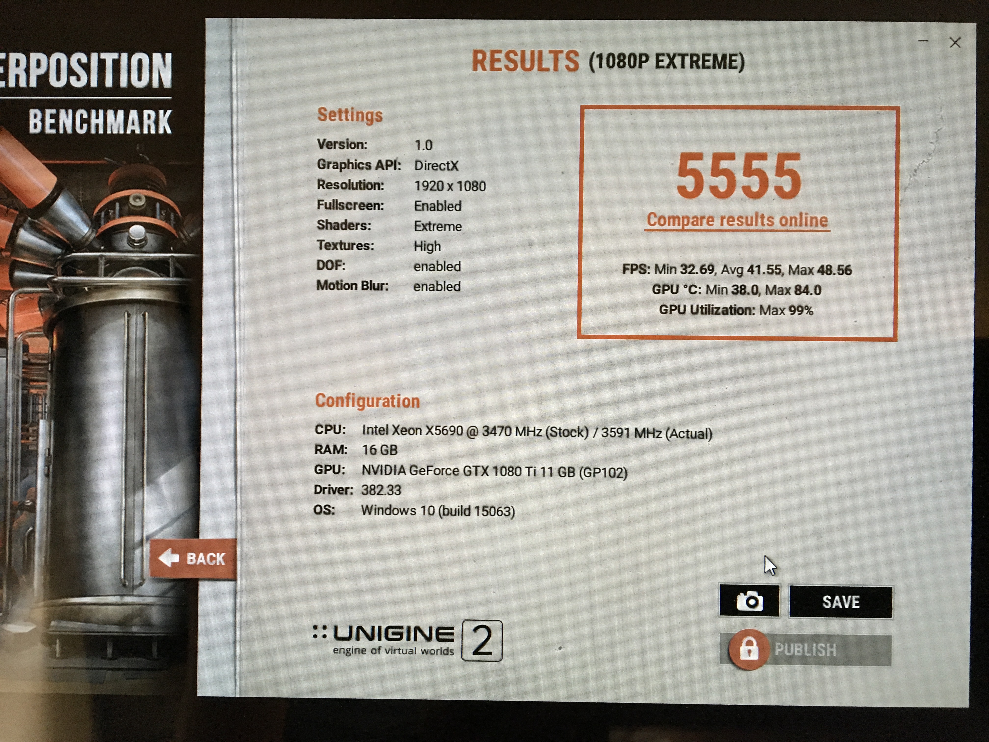

Anyone with a cMP 3,46 GHz (W3690/X5690) and a GTX 1080 Ti here?
Particularly interestings benchmarks: 1080p Extreme (DirectX) and 4K optimized (DirectX).

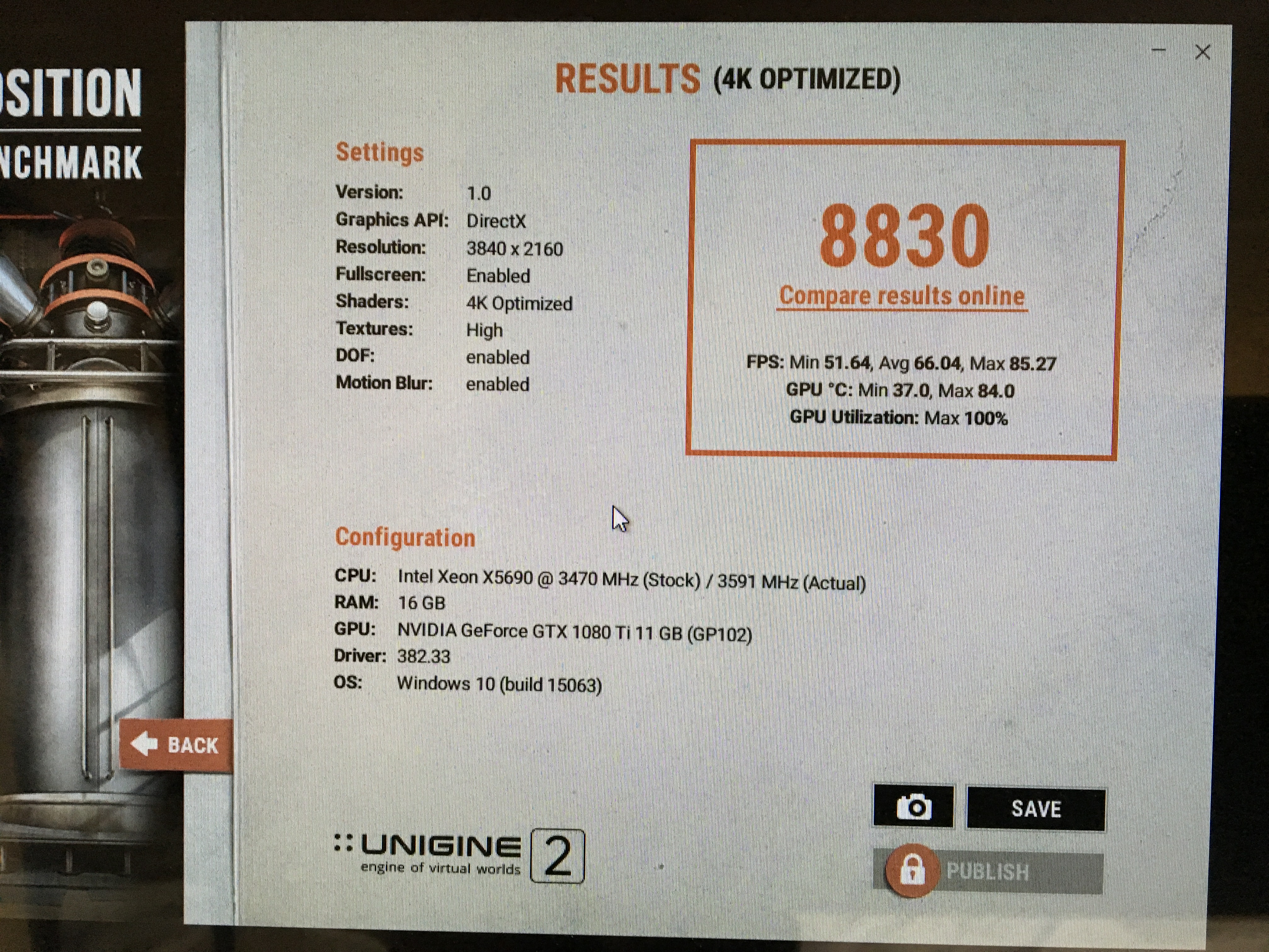

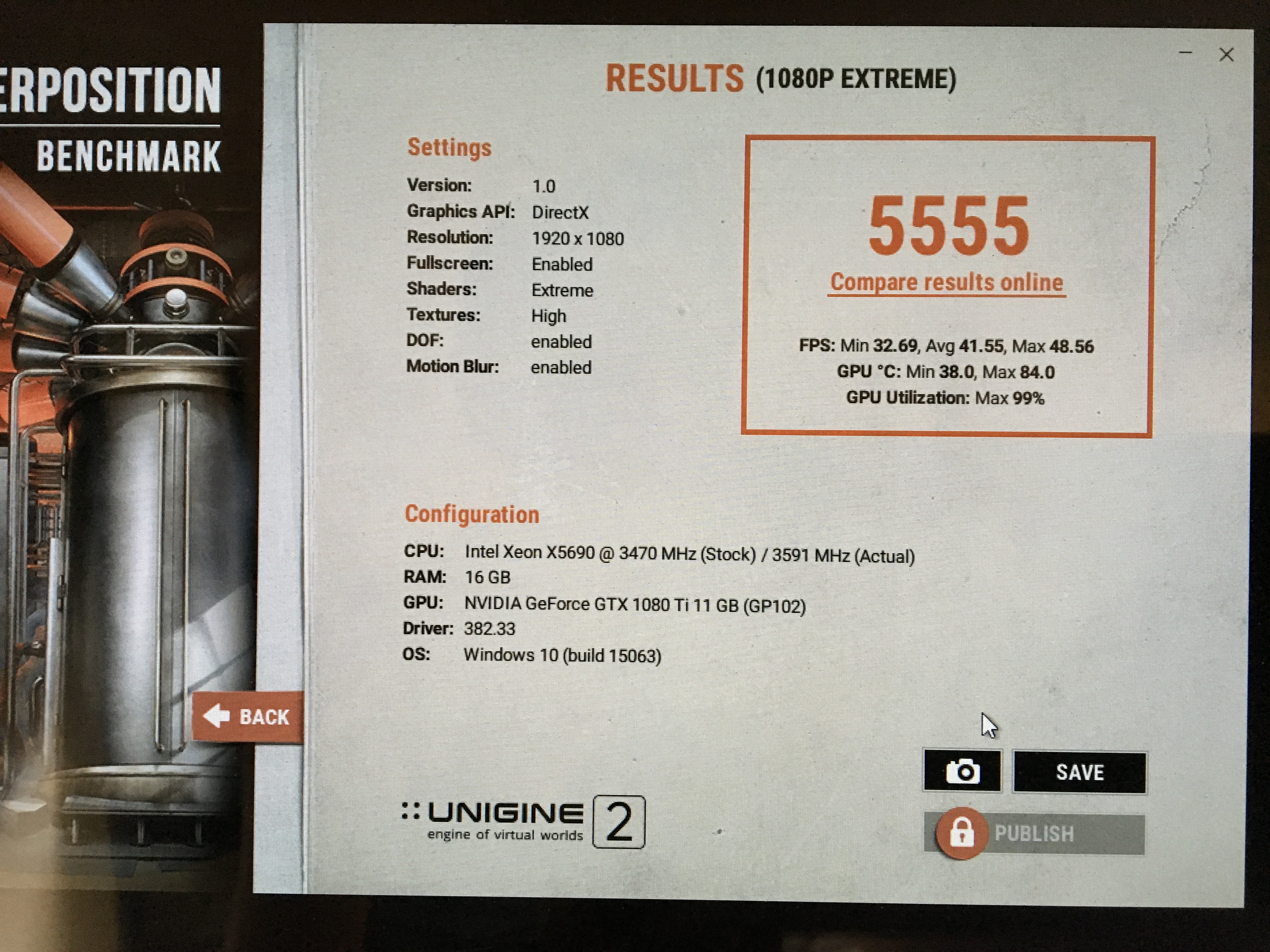

Here you go. X5690 3.46Ghz.
I know it's very hard to swallow. When do people realize the latest advancement of gaming/visual/computing hardware is the GPU. Not the CPU, not USB 3.0, not Blutooth 4.0, and not Thunderbolt. What do you expect any shortcoming or drawback when compare a cMP 5.1 to any lately built Hacintosh, while you understand the point aforementioned?
The PRO badge is real.
1080P extreme: 5555
4K optimized :8830

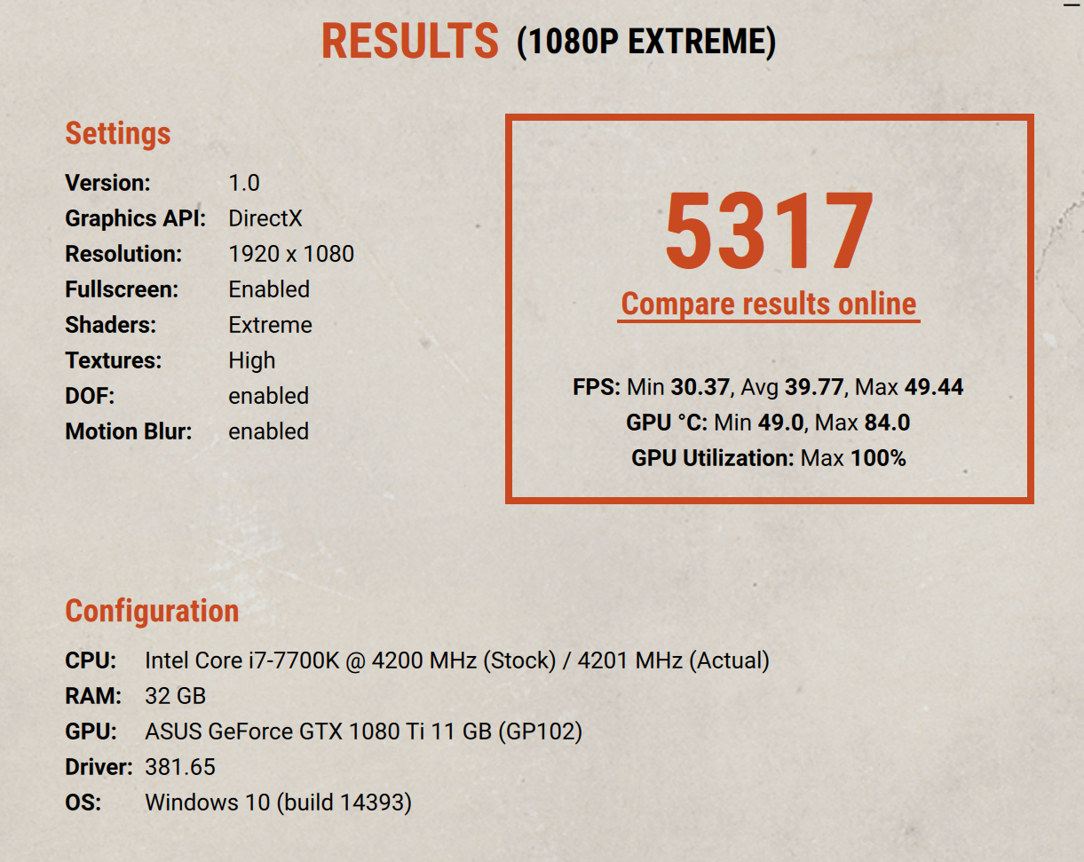

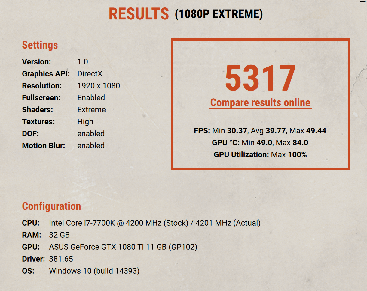

Maybe I should remove my GTX 1080 Ti from the i7-7700K machine, und put it in my Mac Pro 4,1/5,1 ? 😀

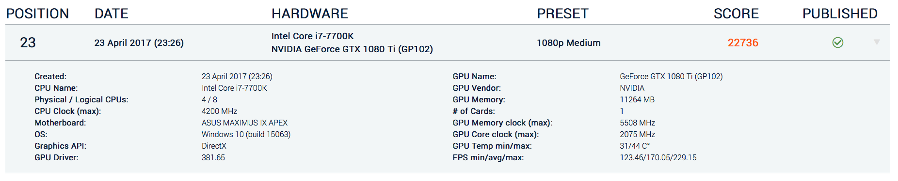

Possibly my card is thermal throttling (small MiniITX case), however here a result from an other i7-7700K:
1080P extreme: 5555
View attachment 701291 View attachment 701292
4K optimized :8830
When do people realize the latest advancement of gaming/visual/computing hardware is the GPU. Not the CPU, not USB 3.0, not Blutooth 4.0, and not Thunderbolt. What do you expect any shortcoming or drawback when compare a cMP 5.1 to any lately built Hacintosh, while you know the point aforementioned?
1080P extreme: 5555
4K optimized :8830

Yep, the 3.46 Mac Pro will trail behind that by around 10%, but honestly, it's a lot less than I thought. I feel better about putting a 1070/1080 in a 5,1 now.
According to an 7700k bench above, the Mac Pro 5,1 is actually faster!
Seems like regardless, the Westmere doesn't appear to be significantly bottle-necking GPU performance....
