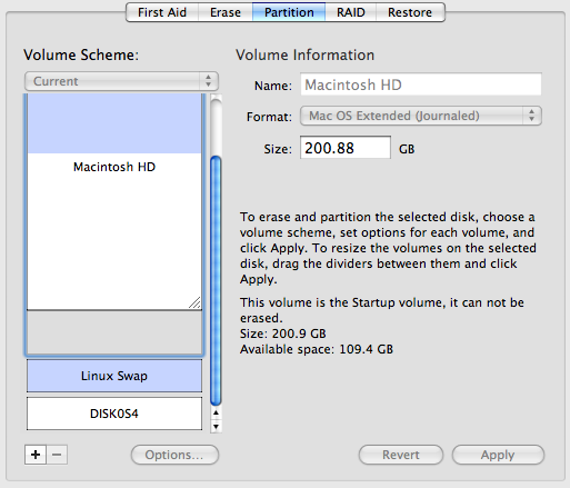

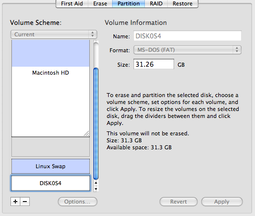

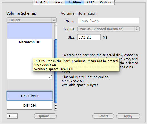

I installed Linux in a partition and now I would like to delete it and delete the partitions. I can't really seem to delete one of them, because it says it's "too small" and the other won't really delete. Here's the page with the instructions on how to install it. Install Linux. Here's some screenshots of my partitions in Disk Utility. Thanks for any help in advance! I really need to get the whole hard disk free for just the Mac. Thanks again!:apple:

I'm not sure what you did but after you select the partition what's the error after you select the minus/remove "-" button underneath the partition map?
Repairing a Linux Swap? How would that help?

No, repairing the disk. There appears to me to be a problem with the partition table as it is displaying the name "disk..." on one of the partitions. Whenever I saw this on my Mac, it was resolved by repairing the disk.

Unfortunately the partitioning table has been messed up, so you will need to reformat your drive to fix it. If you have external storage, you can clone the partitions you want to keep with Super Duper, reformat the internal drive, and clone the partitions back.
It is a long shot, but you could also try installing MacFUSE and see if that makes any difference.
Leaving your drive the way it is might work for now, but you risk developing bigger problems down the road that could ruin your data.
The "DISKOS4" was formatted as FAT. Does this have any effect on what I'm supposed to do? And I'm noticing when I type, it's really laggy, even in TextEdit. Any fixes to this?
Whoa, slow down. TS might still be able to rebuild that partition table. It's not so corrupted that he can't boot so it'd be worth a shot with another disk utility. I'd try with the GParted live CD.
Again, having a messed up hard drive can cause problems with your computer, namely slowdowns due to your computer having to compensate or complete crashes. I would advise that if you don't buy an external drive to instead borrow one from a friend. You will need to erase it, so tell the friend to back up their data first.

Yeah, sounds like you're having major issues. Time to start over.
...Alright...Thanks guys. So the final plan is to backup my data to an external and reformat the internal?
Yes. You can use disk utility to format an external (make sure you choose GUID partitioning!) with two partitions (they only need to be big enough to fit your data) for each of the two partitions on your internal you want to keep. Super Duper will clone each partition to an external partition to back it up (Make sure that you check to make sure you can boot off the external!). After you have cloned the partitions, you can safely erase the internal drive. Just add your partitions back and clone your data back to the internal drive by booting into your external and running SuperDuper (you can also use disk utility to clone if you are booted off the OSX DVD).
