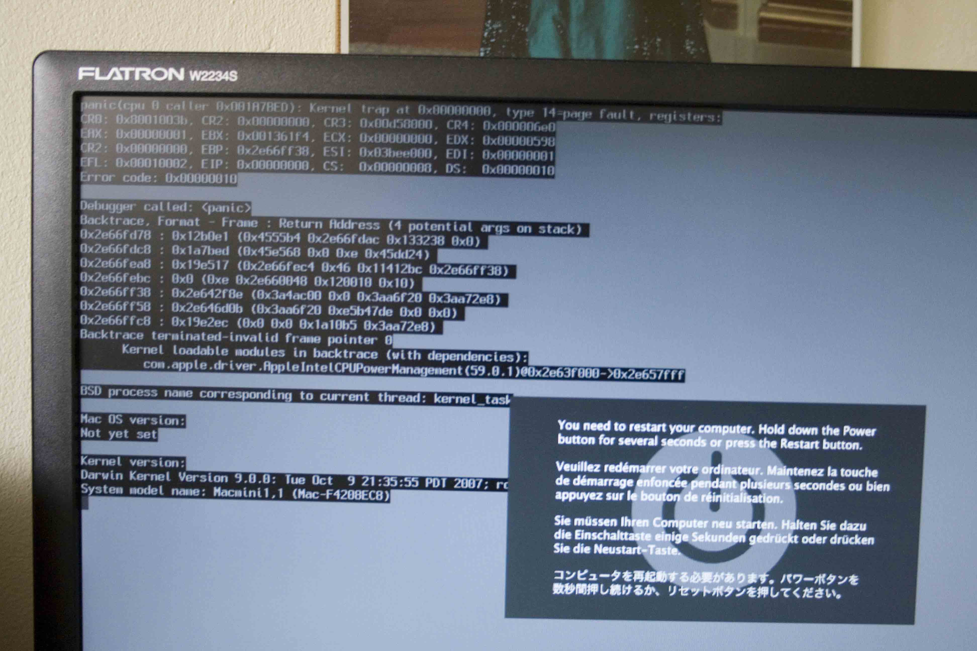

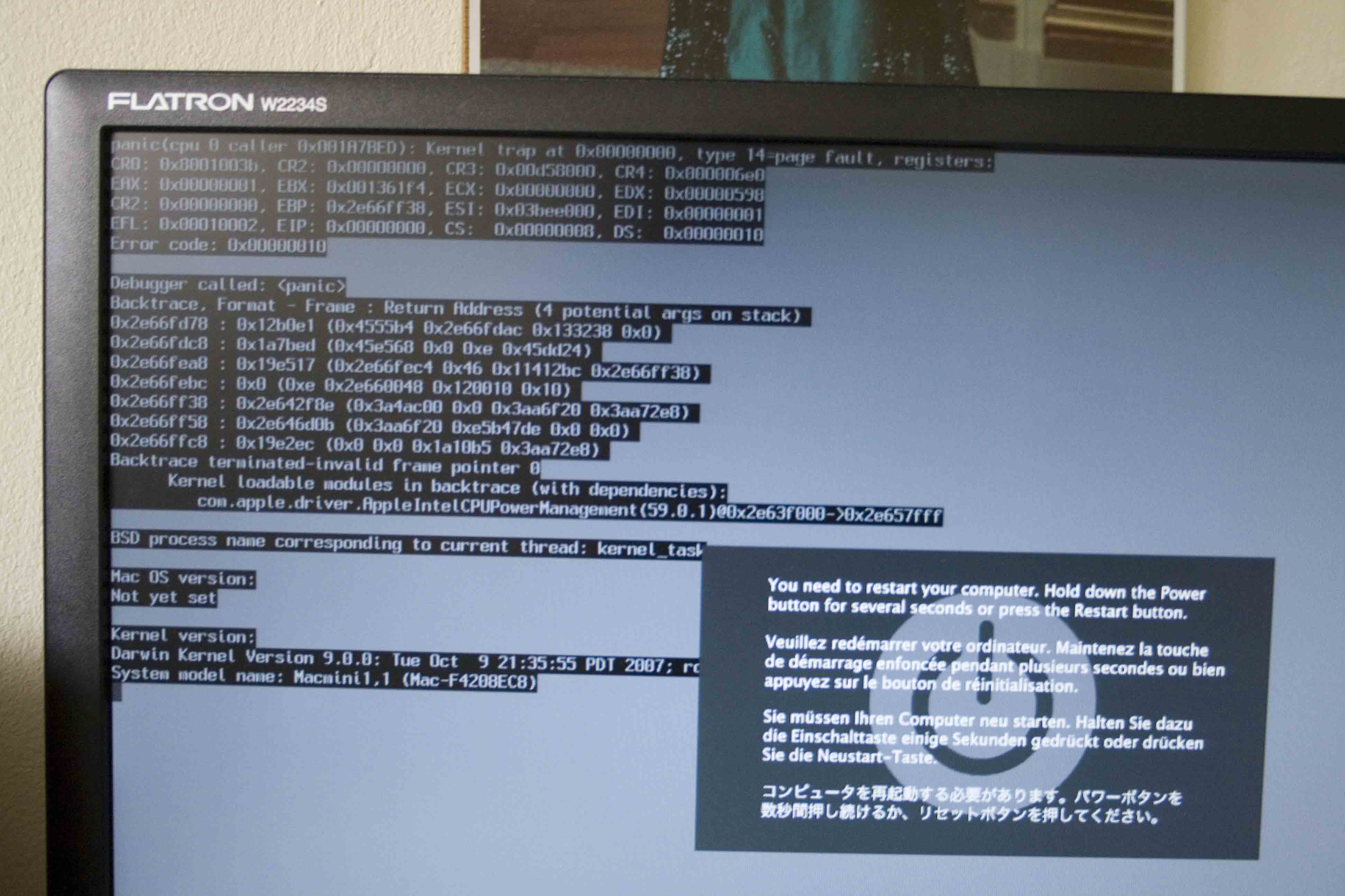

Last night I tried once again to get it working, and it magically did. I installed Leopard from a firewire ipod and it worked (appart from sluggish performance), but then a new problem occured. I downloaded the latetst combo update 10.5.6 from Apple and installed it overnight, to be shure that wouldn't be causing the problem. When the update was installed, I rebooted the machine and (continualy) got this crashscreen error while booting;
Does anyone speak code by any chance, because I can't understand most of it.

It's likely the hard drive in your iPod is failing, a successful install followed by a massive rewrite the disk causing corruption or unreadable sectors is possible. Make sure your test equipment is 100% known good. Try the second Mac after you've confirmed it's hard drive is healthy.
Second, the kernel panic is crashing on power management, which along with the AHT error code, seems likely something on the main logic board has failed.

To be clear, the screenshot of the bootup error message was with Leopard installed on the internal drive (which was booting fine before, although with sluggish performace) after updating to 10.5.6.

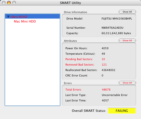

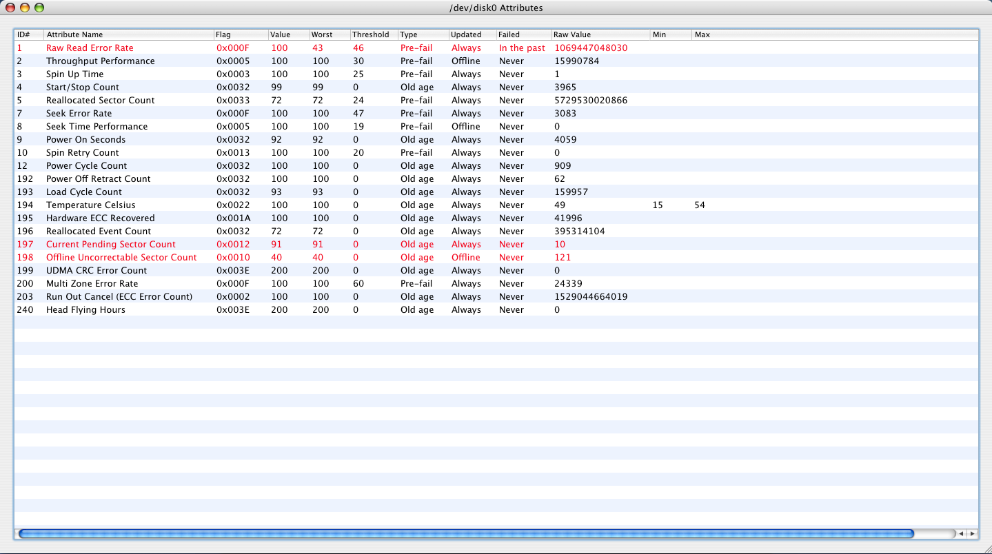

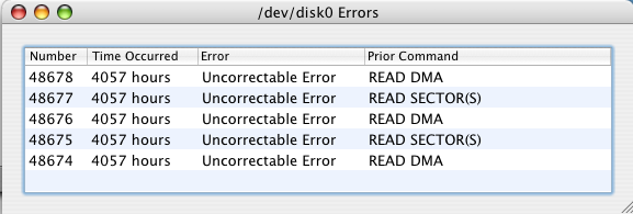

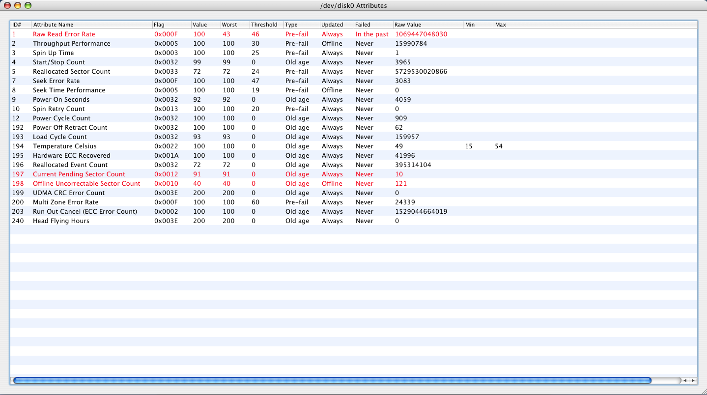

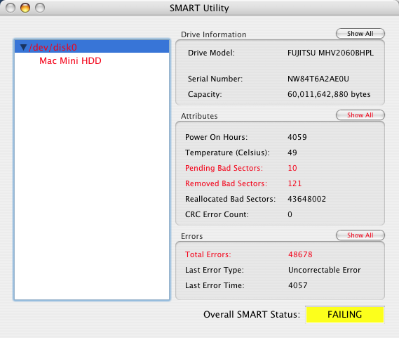

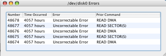

I ran Smart utility (from the booted iPod with Tiger installed) and it gave me the following screenshots. (note that there is only one drive visible (my internal Fujitsu Mac Mini drive) but there should be two I guess (one internal Mac Mini drive, and the healthy firewire iPod I am booting from). Please, do the screen shot messages (apart from the failing drive) tell us anything ??
Moreover, your strategy on isolating the problem sounds very much like the way to go in order to find the problem. Although I am reasonably handy with computers, I must admit that I don't know where to start with this isolation proces. Again, any help is greatly appreciated.

SMART readings are typically not available from firewire or USB devices. What that is showing is your internal hard drive, in your mini, is failing. This is likely the cause of all the issues. Replace the internal hard drive and you should be fine.
The previous kernel panic at boot posted was likely just from the inability to properly read the module related to power management. If you can boot from a firewire device and the machine functions normally, regardless of any updates, the fact that it ran, and ran stable, should prove all components but the internal drive are good.
