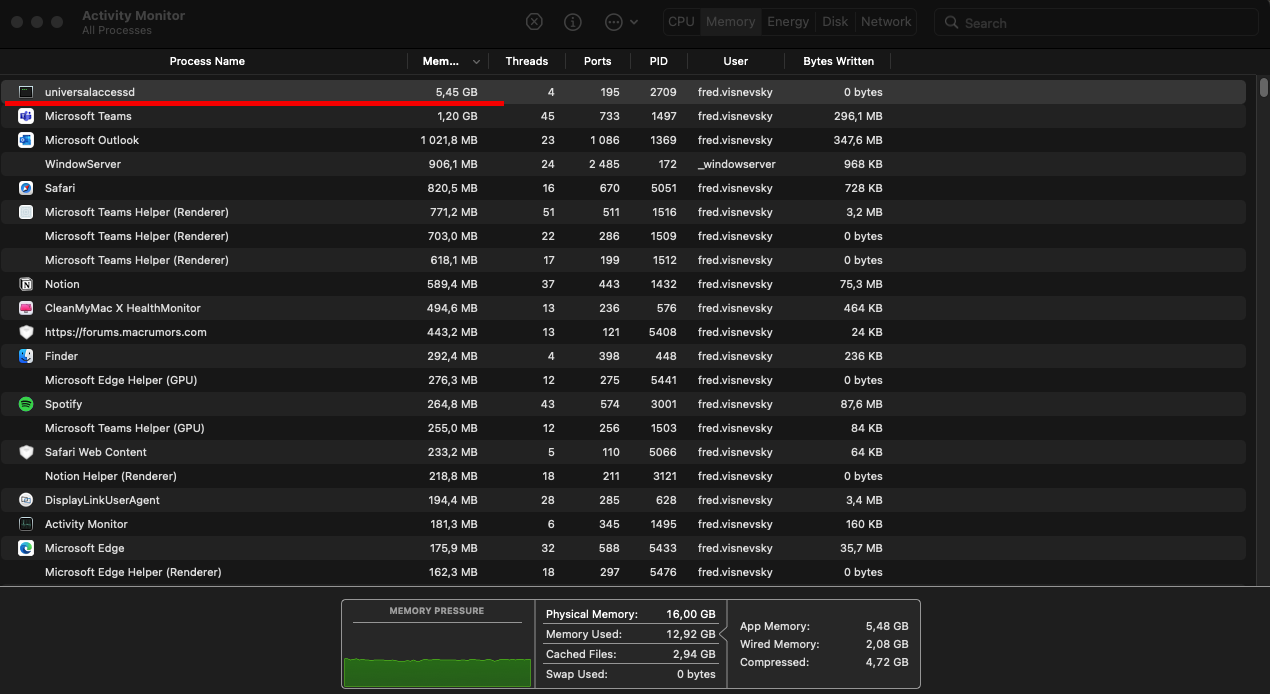

Thank you for the input.
This issue is new, as I have been using the above-mentioned apps for months without those issues.
Regarding Cleanmymac - I agree, it's trash. Got rid of it. However, for the other two - DisplayLink is mandatory to use on M1 pro if you have more than one external screen. No other way around this (unless you know something else - please suggest).
Even after turning all of them off, the issue still occurs. The RAM usage by the service keeps getting bigger and bigger.
What is that service even related to?
I mean... honestly. What the hell is this? A memory leak?

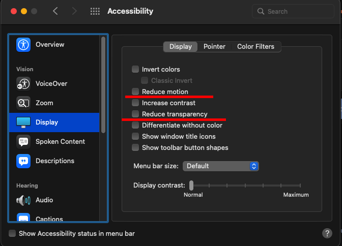

I think I've found a solution.
Had both settings turned on, seems there is a bug in the new version.
After turning it off
Hopefully, it won't creep up again.

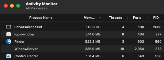

I have this same problem with MBA M1. Today, when I first opened the laptop, everything went fine for a while, but then a pop-up message saying my apps are using too much memory appeared. The culprit in the pop-up seemed to be Firefox (using 32Gb of memory -- out of my 16Gb???). Went and did some research and didn't have to look a far as those articles about the memory leak shed some light.
Now I've been checking the activity monitor and every time I wake my MBA from sleep 'universalaccessd' jumps up by 200-500Mb. And it does that every time the laptop goes to sleep and wakes up. After 30 consecutive sleep-wake up cycles it was using 8Gb of memory. None of the solutions above have worked.
My best quess is that this is part of the same problem like the rest of the Memory Leak problems in macOS Monterey which have now started to appear. MacRumors, MacWorld and DigitalTrends have at least acknowledged this (https://www.macworld.com/article/54...-leaks-m1-macbook-macos-monterey-big-sur.html)
So. Most propably we have to wait for the fix from Apple.

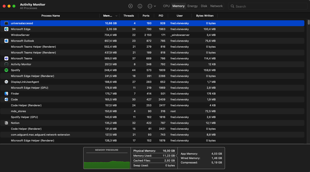

This is my machine right now:
I turned off the "reduce transparency/motion" settings but it didn't appear to help in 12.0.1 on an M1X. I DO however have the zoom accessibility function enabled (I legit need it to see).
So I killed the process and everything was fine. If I zoom the screen in and out a few times, the process size jumps from 60MB to 100, then 300, then 600MB. I zoom back out and do nothing... everything's fine.
Then I start zooming again and the process size starts soaring again. 1GB, 1.6GB, 2.45GB. One single zoom in/out seems to leak between 40 and 150MB of RAM.
