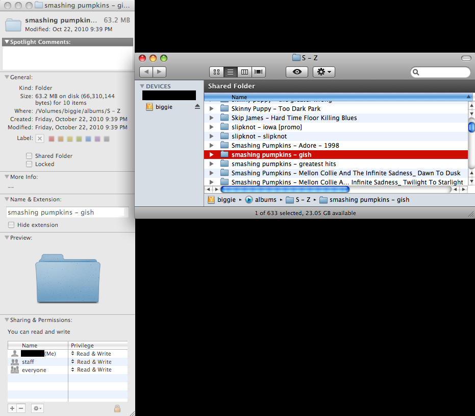

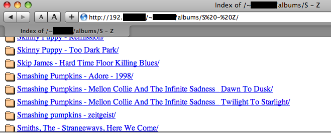

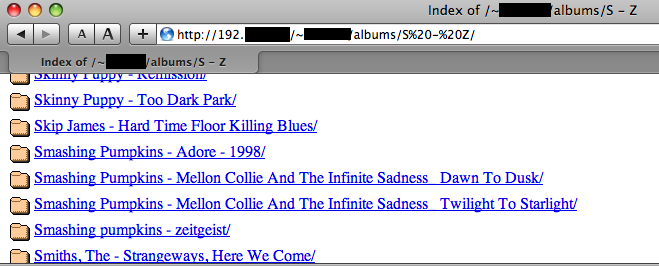

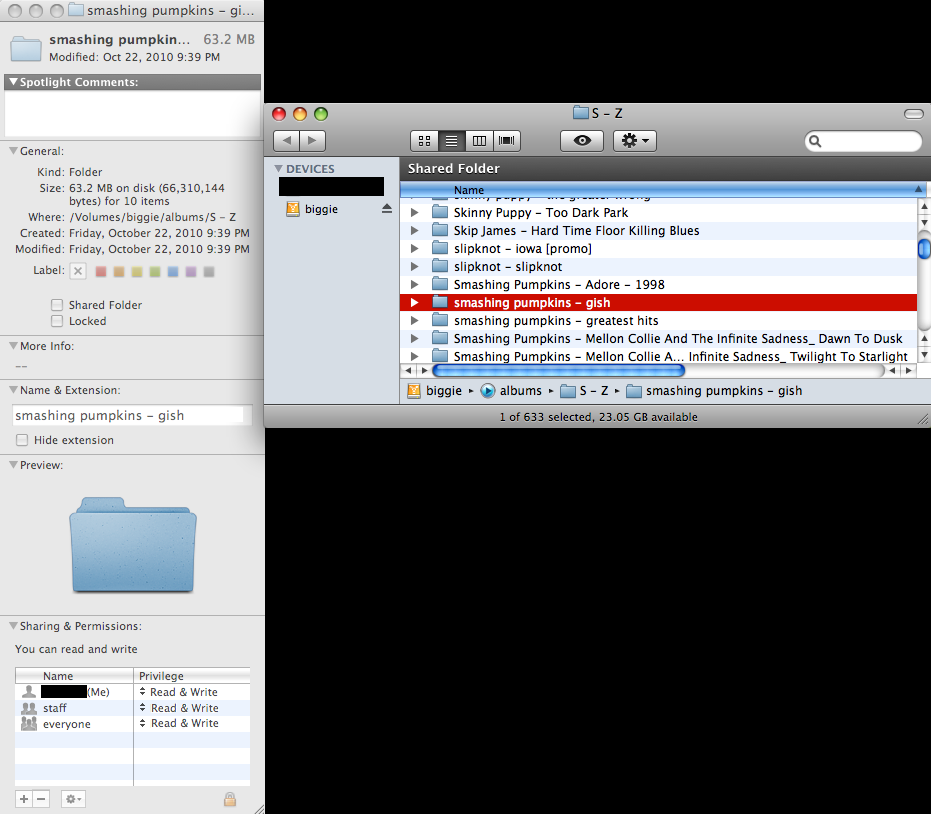

Okay, I figure it's much clearer if I show you the problem rather than trying to describe it in words.
In the Finder you see all the folders that are in the directory, but then on the web page for that directory you can see that a bunch of the folders are not being listed.
How do I fix this?

Hmm... that is weird. It certainly looks like it should work from those images you posted, and there's no reason that filename would be problematic since the ones below it aren't.
