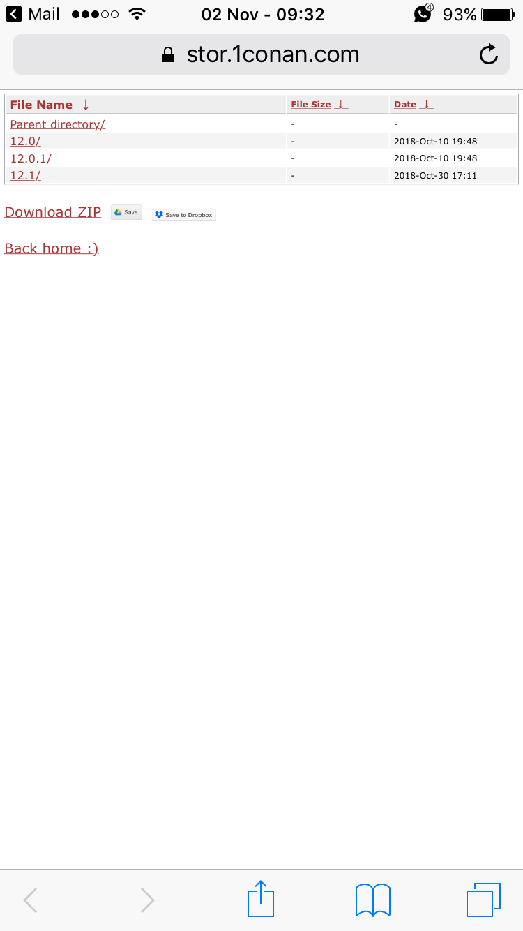

I've already saved the iOS 12.0.1 blob. Pic below. It's currently sitting in my mail inbox and saved in my Dropbox. So I should be able to upgrade from my existing 10.2 at a later time.
But I never saved my iOS 10.2 blob so absolutely not a chance to downgrade if I were to upgrade.
