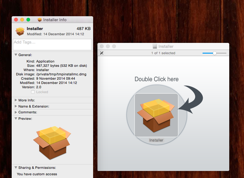

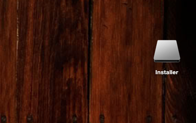

A couple of times now I've had an Installer appear on the desktop without any kind of action from me.
attachment.php
The first time I just ejected it, now it's come back I'm really wanting to know what might be causing this?
When I open it and Get Info it doesn't reveal too much (to me).
attachment.php
Any thoughts on this? Would be much appreciated. I haven't installed anything outside Steam for a couple of weeks now, the only exception being Flash updates, could that be causing it? Or related to it in some way? I've had Flash Plugin crash on Safari since the latest update but it is working fine now.

Thanks for that.
Little more technical than I can grasp completely but it seems to suggest to me this was more serious than I had first imagined?
Following a couple of the steps in the link, hopefully that will be the end of it. Cheers!
