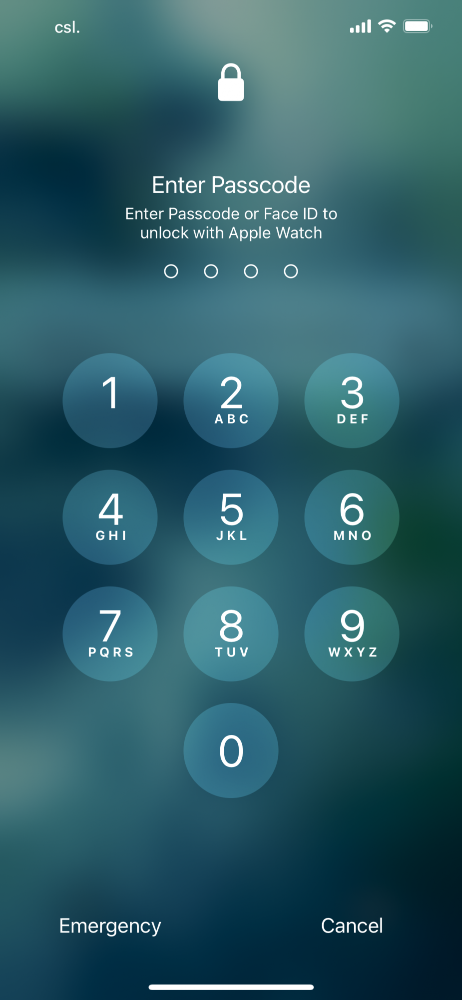

Hello guys, I've just updated my Apple Watch to WatchOS 7.4 RC and my iPhone to 14.5 RC, restarted and removed the beta profiles afterwards. I enabled the "Unlock with AW" feature in the iPhone settings, but my phone is not unlocking even once with a mask. The watch does not give any feedback at all, I just get the regular "fail buzz" on my phone and then I'm prompted to enter my passcode.
I tried several times and it's the same every time. Restarted the phone and watch again, turned off and then re-enabled the feature, but nothing seems to work...
Any suggestions?
Thank you in advance!

Just updated to 14.5 and Watch 7.4 and after everything was enabled my phone asked for my passcode on the first attempt while wearing a mask then every time since it unlocks the phone and vibrates the watch saying the phone has been unlocked. If I click on lock phone from the watch, it locks the phone and mask unlock won't work again until I enter my passcode on the phone to unlock it.. Maybe you need to restore the phone due to some sort of corruption in the update
Just replied to someone else here on it too. I’m having the same problem. It worked like twice. Once it came up and I accidentally hit “lock” on the watch prompt. And it never worked again. It’s enabled. I’ve turned it all off an on again. I get a screen that says “unlocking” and then it asks for the passcode. Never worked again.

This **** is Apple Tech at it's finest. Long time coming. Not working. All I get is this non-sensical prompt that I need to type in my passcode to unlock with Apple Watch. Then what's the Apple Watch for?!

Had the same issue. I had tapped lock iphone on my watch to test that capability and then could not do a masked unlock again. Tried rebooting iPhone and Watch but still didnt work. Disabled Unlock with Apple Watch then re-enabled it and its working again. After 8 betas I hoped we wouldn’t have issues like this

This is exactly how it is supposed to work. You only need to tap on the "lock phone" from the watch when the iPhone is unlocked without your consent or permission. For example, if your iPhone is stolen and gets unlocked.

This does seem how they designed it. The first time you unlock with mask and Apple Watch, it asks you for your iPhone password and will continue to work until you reboot your phone or watch. If you choose to lock your phone via the Apple Watch, the next time you go to unlock your iPhone, it will ask for your passcode, regardless of mask or not. Once you enter your passcode, it continues to work as normal. At least this is how it's working for me on my 12 Pro and S6 Watch.

You don't need to throw anything away or erase any data. All you have to do is re-enter the passcode on the phone to re-activate FaceID and unlock with watch works again.
I had to reboot both the Phone and Watch after their updates to allow the connection to work. Powred off both, powered on Phone then Watch.
That solution worked for me. Thanks!
I've been using this feature since it's launch in beta phase and it worked well, but since I updated to the final/RC versions of iOS and watchOS, it stopped working and it was driving me nuts. Turns out, all I had to do was powering off and on both devices and now it works like a charm.
