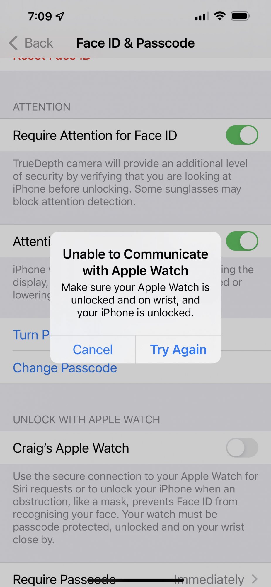

Picked up my iPhone 13 Pro Max earlier this morning and I’m having issues with turning on “unlock with Apple Watch” feature under Face ID settings.
It keeps telling me “unable to communicate with Apple Watch”. My watch is paired and shows up in the Watch app.
When I set up the new phone, I chose “restore from iCloud backup” and tapped yes when it asked me if I wanted to pair my watch with the new phone
I’ve already tried the following:
- Update iOS 15 (there’s a small update ~450MB after you first set up the phone)
- Unpair and re-pair my Apple Watch
- Power down both devices and restart
- Reset Face ID
- Toggle “unlock with iPhone“ in Watch app settings on and off
I raised this in the first impressions and Australian preorder thread and it seems a few of us are having the same issue.
I’ve already provided feedback to Apple via https://www.apple.com/feedback/
Please also log similar feedback so Apple can understand the extent of the problem and fix it ASAP. This was sooooo useful when wearing a mask and trying to use the phone.
Edit: @Alkmaarder seems to have found a workaround after talking to Apple support
SOLVED
I have contacted AppleCare Support today ... Basically there are two options:
1. Wait until next update which will solve the issue. And use code / no mask in meanwhile.
2. Workaround:
- Make a NEW Back-up for the iPhone13 (Pro).
- Erase phone and set up as new phone.
- Restore from backup iPhone13 NOT from original backup (iPhone11/12 etc).
- Go to 'settings' > 'Face ID & Passcode' V 'Unlock with Apple Watch' ... now the toggle switch and connection should work!
I can confirm that (2) DOES work. Backed up to a Mac, erase all contents, restore from Mac and ”unlock with Apple Watch” is now working for me again.

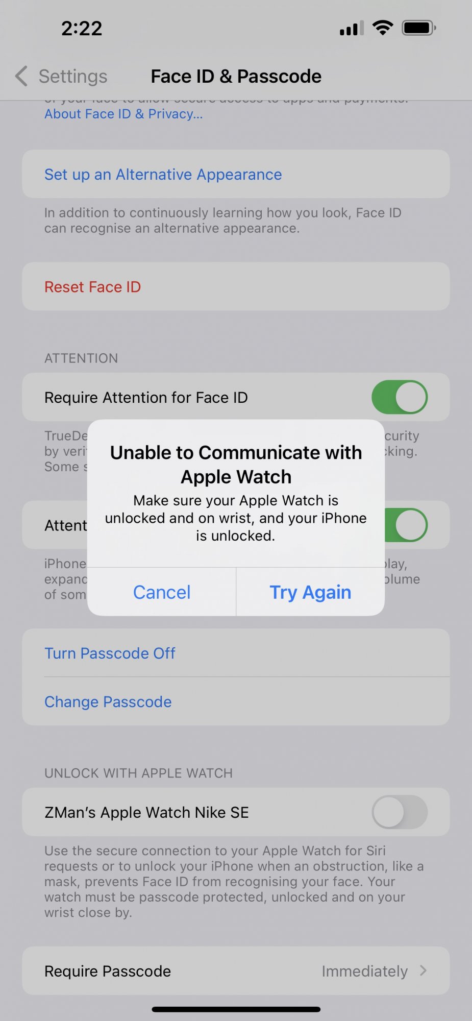

I set up my iPhone 13 Pro Max today and now I can not activate unlock phone using Apple Watch. I keep getting error message unable communicate with Apple Watch.
it seems there are a few others having the same issue. I have reported to Apple on their product page.

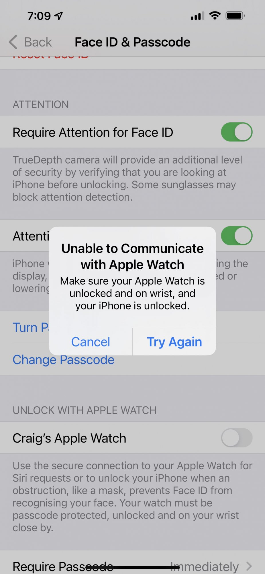

- Reset Face ID
