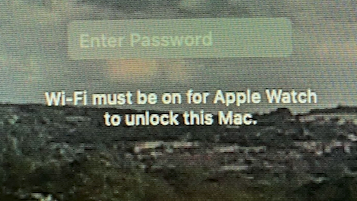

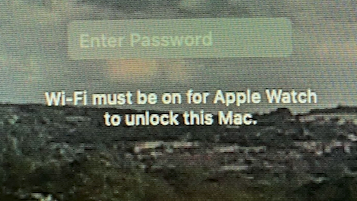

I don't think the wireless network has any effect on Apple Watch unlock. I have my Mac mini connected via ethernet and Apple Watch unlock works great for me.
As you can see my Mac prompts me as follows:
