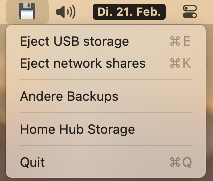

I have a few drives connected to my dock. Often I just unplug ad get a lot of annoying notifications. Is there a way to either disable them or run a macro that automatically un-mounts all drives?
Thanks
Yesterday I wrote small app exactly for that purpose.
It can eject USB connected as well as network volumes and also lists them separately in a menu from where they can be accessed. It purposefully ignores SD-Cards. It can be customised at will as it's AppleScript based.

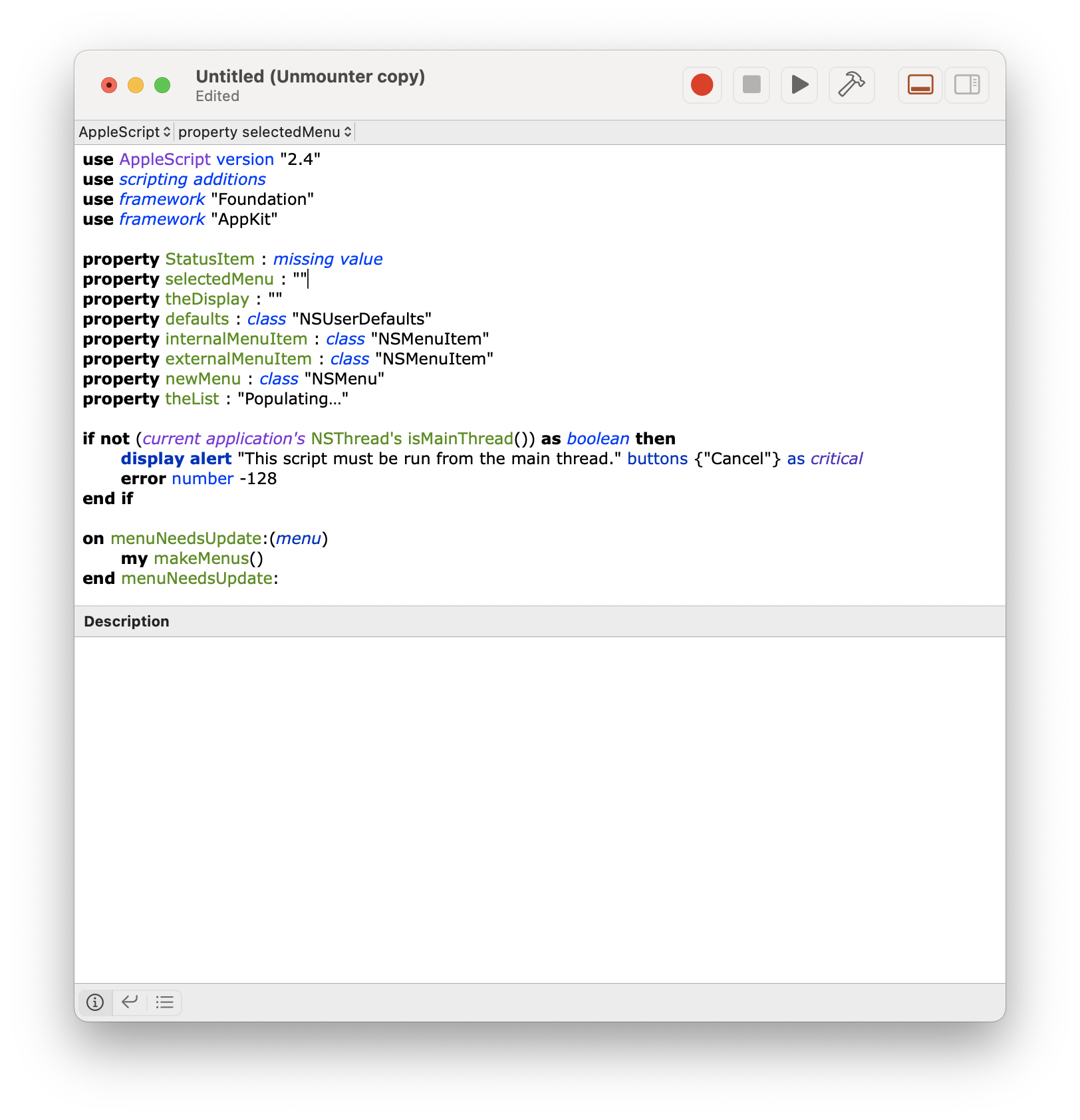

Rather than sharing the app, consider sharing the code and how to save it as an app.
https://support.apple.com/en-us/guide/script-editor/scpedt1072/2.11/mac/11.0
Inexperienced users will be welcomed by the “unidentified developer” message when trying to open the app.
So here you are:
To generate an application from the script (it can't be run as a script) follow these simple steps.
  1. Download the script and unpack it (if not done automatically).
  2. Open the script with Apple Script editor (preinstalled with the OS).

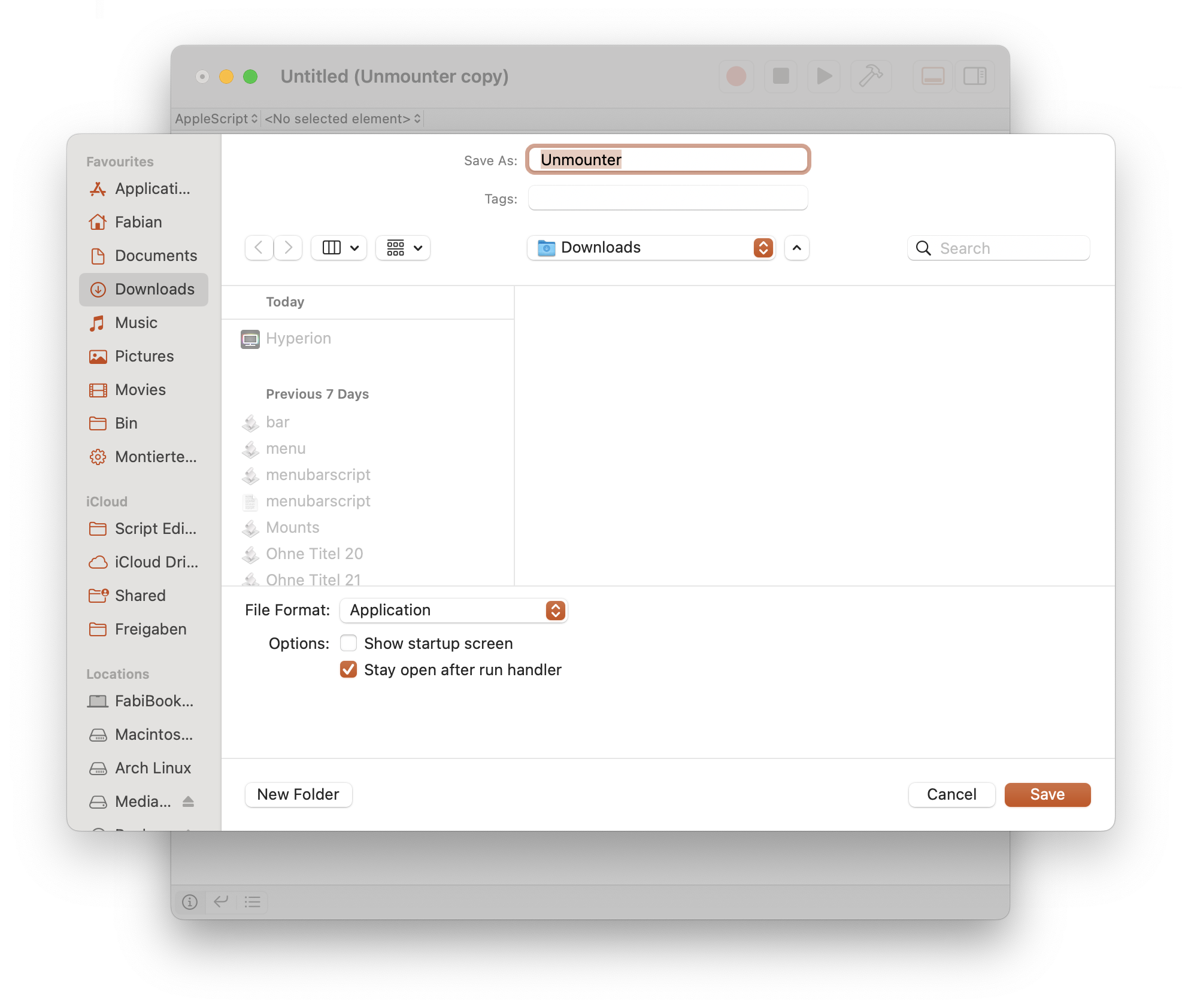

  3. Select Duplicate from the File menu.
  4. Save the script as an Application with the following settings enabled.
