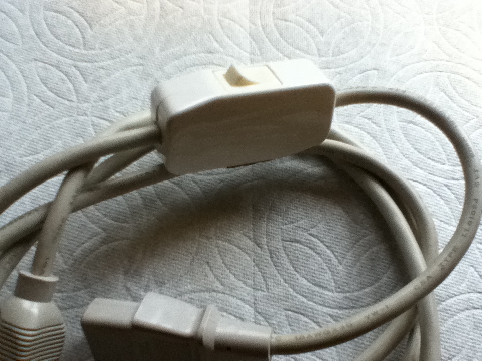

I've had the exact same issue with 1 of my MDD's.
To save wear and make things a tad more bearable I installed a switch in the power cord as shown here.
Been working just fine now for several years.
REALLY A HAPPY CAMPER NOW! Thank you so MUCH for your input to keep an old G4 alive. No more leaving the G4 sticking out so both end were showing.
